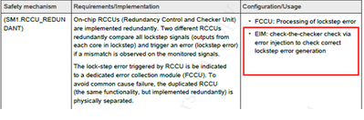

Once the safety manual is updated to 6.0, there are some comments for configuration as below in the red box.
Is it only information or what should the user do for this?

Hi Heebeom, SM2 usually inject failure using the EIM interfaces (not always). If you use NXP SAF Scheck (recommended), you do not need to implement anything else, EIM fault injectino is transparent to you.

The user needs to do the error injection to be sure that the ECC check is working.

Normally, SM2(es) are supported to check the functionalities of checkers.
In terms of the purposes, instead of using the SM2 can be sufficient at least for ECC and Gasket and so on?
