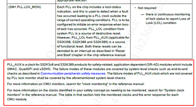

Once the safety manual is updated to 6.0, there is additional comment like below.
[Questions] What does it the aforementioned system level checks? It is more like E2E protection? If not, can you specify which system level safety measures shall be used?

HI Heebeom,
Yes SM4 E2E protection is the mentionned safety measures. If clock is incorrect, it will result in corruption, or delayed covered by the SM4 E2E safety mecahnisms

john_floros
This is SM4 E2E protection and is a software safety mechanism, to be implemented by the system developer.

HeebeomPark
Back to my original question, only SM4 which is E2E is sufficient to cover what Safety Manual describes?
