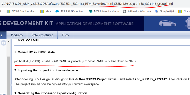

I even don't know how to control SBC
Who can help me!!!!!!

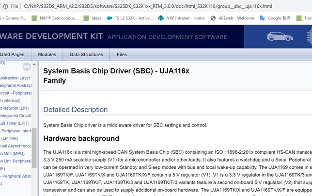

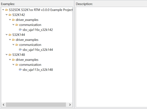

Hi@LijieDu
you can refer to these demo in the picture below,the procee should be same.
Some modifications on the port
By default, the CAN function of UJA116x is enabled, which means that you can use its CAN communication normally without configuring UJA116X.
Some reference guide.
restore factory state
The above are some demos and guides about UJA116x.
For more details you need to read the UJA116x data sheet
