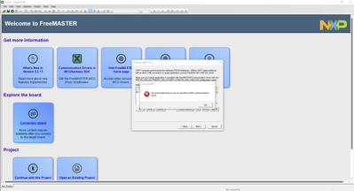

Hi I'm in the process of evaluating S32k1 family microcontroller for our project. I'm using S32K118EVB2Q048 demo board for testing.
I'm having problem using FreeMaster to detect my board. The following error shows when I run the connection wizard
I can see the board on my device manager and able to access the device from file explorer perfectly fine.
I am following the getting started tutorial from https://www.nxp.com/document/guide/getting-started-with-the-s32k118evb2q048-evaluation-board:GS-S32K...
I am also having problem getting the preloaded demo to run upon pluggin to power. Jumper configuration has already been changed as suggested in the tutorial

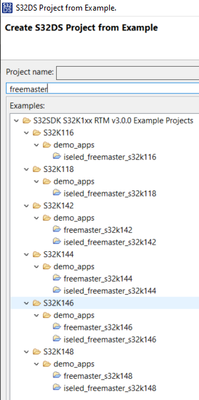

The JumpStart Code with FreeMASTER in the Getting Started you mention is for S32K116-EVB. Apparently it's a page error, I'll report it, sorry for the inconvenience.
The FreeMASTER example available are the following:
Hope it helps you.

@_Leo_ Hi Thank you very much for the suggestion. I managed to get the LED blink program running using S32DS. But the problem with FreeMASTER 3.2 still persists with this board.
I tried creating a new project on FreeMASTER and ran the connection wizard, it still fails to detect my board.

Please try using the examples I mentioned above.

Hi I'm using SDK RTM v4.01. i dont see any freemaster examples here for S32K118...
