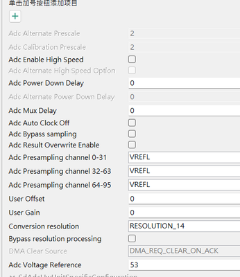

I have some problem on measure s32k358 mcu temperature, I also check other post on NXP community, but I can't find the problem, please help us check, thanks.
The following is my ADC setting :
Function code I follow the formula from S32K3RM
I get Mcu temp raw data about 8208, and after ADC 8208* (3300/16384)
and formula from RM then can get MCU temp = 48~49, I think the value is not correct.
Is there any wrong setting in my MCAL or code?
BR, BillWen

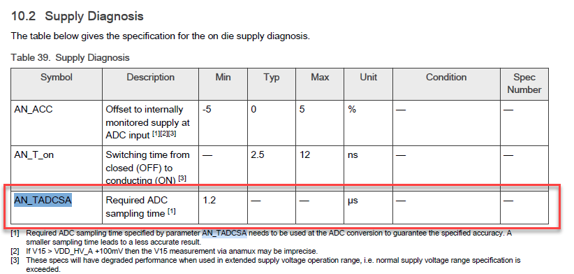

The TEMPSENSE output can be read by an ADC on demand so that the software can determine the current die temperature. The software should enable the TEMPSENSE by setting ETSCTL[ETS_EN].
Secondly, there are requirements for the ADC sampling time of the temperature sensor; it must be greater than 1.2us. I suggest you use a larger value.

First, the calculation process you provided is correct, but I see some obvious errors:
1. The parameter you entered here is 53, which is 0b00110101.
This indicates that the reference voltage is 3.5V, not 3.3V.
So this should be wrong :ADC 8208* (3300/16384)

For the parameter you entered here is 53, which is 0b00110101.
I change the value to 3.3V(51) or 5V(80), I still get the same raw data. I use the same way to get mcu temp just like how I get other ADC value, is it correct? or do I need to use Adc_TempSenseGetTemp function?

Thanks for your support, I find the problem.
After I fix my problem, I get the temperature around 35~36, it seems normal I think.
