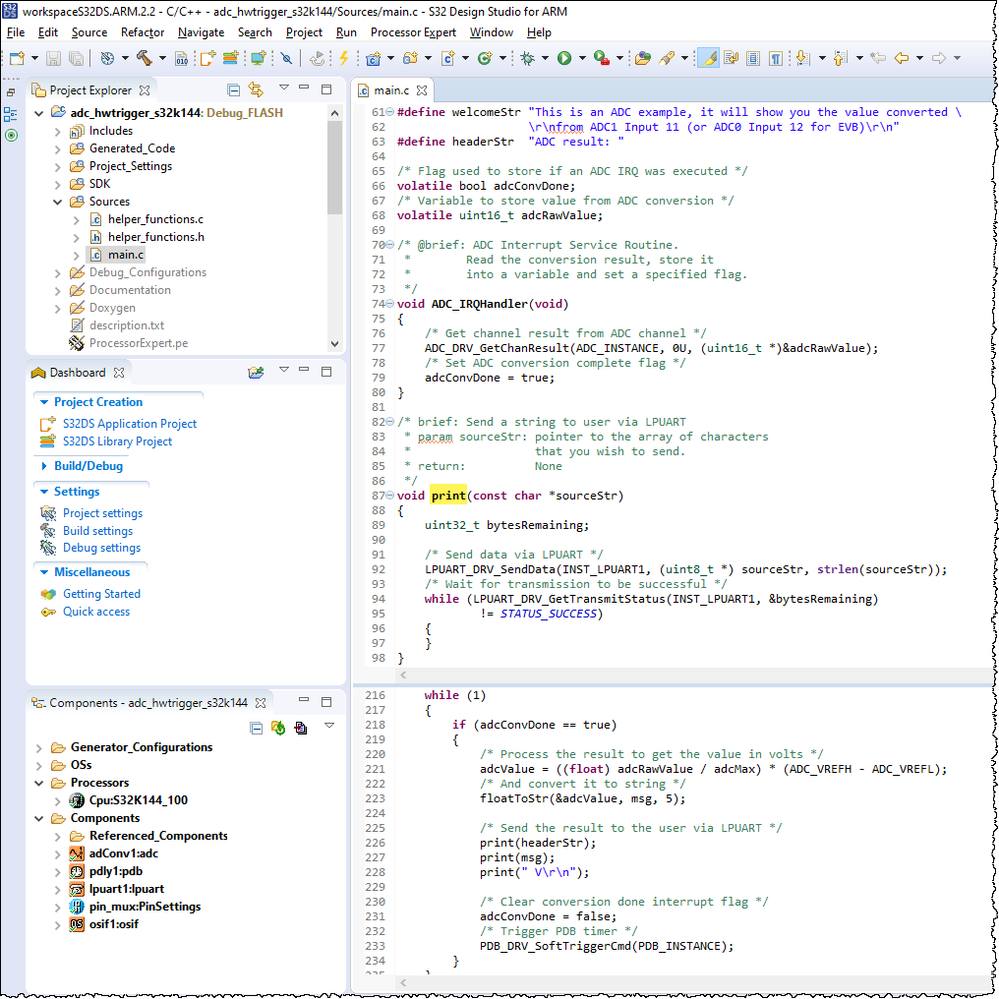

Robin_Shen
Hi akhilranga,
Please refer to adc_hwtrigger_s32k144 in S32SDK S32K1xx RTM:
I don't know what version of S32DS you are using. Here are the two latest SDK versions in S32DS ARM2.2 and S32DS 3.4:
S32 Design Studio for ARM 2.2 - Update 1 available
S32 Design Studio v3.4 S32K1 Service Pack 1 released!
Robin

Robin_Shen
Please click "Generate Processor Expert Code" and then Build the project.

Robin_Shen
The example documentation can be found in the S32 SDK documentation at Examples and Demos section. (<SDK_PATH>/doc/Start_Here.html) Please read the manual of ADC Hardware Trigger
