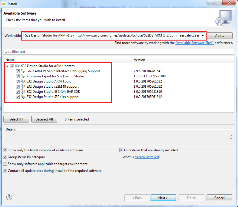

select all available items and click "Next" button

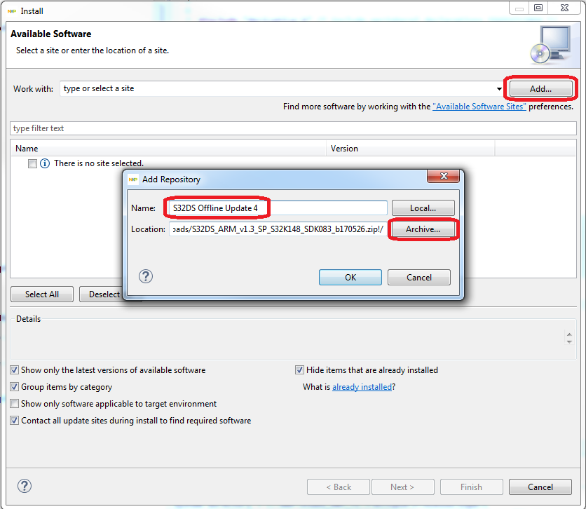

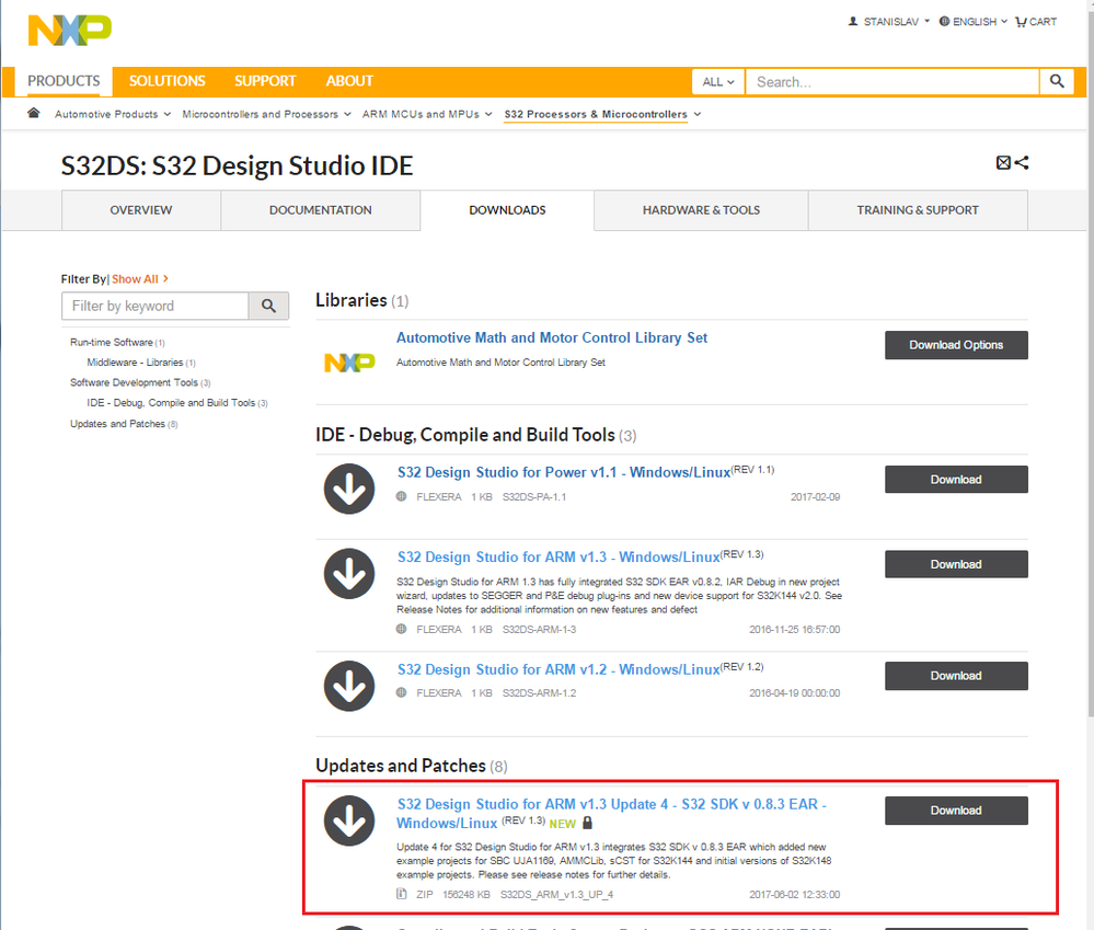

  • offline installation: go to S32 Design Studio product page -> Downloads section or use the direct download link to download the "S32 Design Studio for ARM v1.3 - Update 4" file.
Start S32DS and go to Help -> Install New Software...
Add a new "Archive" repository, browse to select the downloaded Update 4 archive file.
Select all available items and click "Next" button.
