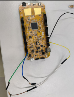

We are trying to use the project example "lpi2c_master_s32k144" and we can not see the i2c signal with the oscilloscope in this line.
We are using an external pull-up for the scl and sda connected to 3.3 volts.
We tried also with 5 volts.
Thanks in advance.

Hello @adrimen3668,
The J2.19, J2.20 are not routed to PTA2/PTA3 by default.
Use J1.1, J1.3 instead.
BR, Daniel
