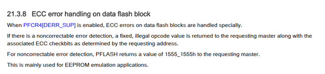

Hi Sir,
Would you have any register to check the ECC fail about the IP C40(FEE/FLS)?
656 Views
StephenYeh
Hi Sir,
We know that the ECC feature is enable, would you share the register(memory map)to us?
649 Views
davidtosenovjan
Regarding data flash block used with EEPROM emulation (FEE) there are handled specially.
Multibit ECC errors happened during code execution or data read are reported to ERM (Error Reporting Module).
