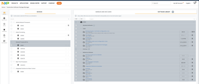

Issue: freertos is not found in the toolchain/IDE project. The project will not compile!
Level: Error
Type: Validation
Tool: Toolchain/IDE project
Origin: Peripherals
Target: Toolchain/IDE project: M7_0
Resource: platform.os.freertos
Hi Supporter
I have problem when using s32k344 with freertos in S32D3.5, how to solve it

Hi @RomanVR ,
Thanks for the reply,
I'm using the recommended configuration of tools, If you have an accurate suggestion about this, please give me more suggestions.
Automotive Software Package Manager | NXP Semiconductors
Thanks and BRs,
MaoHuynh

Hi @maohuynh
Could you please provide us an image of your installed updates in order to try to better identify your issue? To do so, please access from S32 Design Studio >> Help >> S32DS Extensions and Updates.
Since some packages need to be installed previously in order for FreeRTOS to work properly, I require to see which ones you have installed yet.
I'll be pending on your answer.

Hi @maohuynh
Could you please share the RTD version that you're using? Since FreeRTOS 4.0.0 is designed to work properly with RTD 4.0.0, if you are using RTD 5.0.0 that might me the root cause of your issue, given that for RTD 5.0.0 you should install FreeRTOS 5.0.0.
Please note that on the page where you download your FreeRTOS version (this applies the same for RTDs), there is a Release Notes PDF document, there you will be able to find which S32DS version and update, and which RTD version is compatible with that FreeRTOS version, however we recommend to work always on the latest versions.
Please let me know if you have more doubts.
