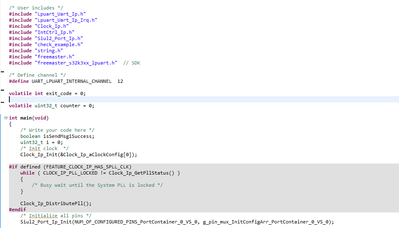

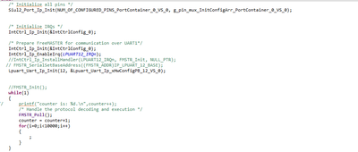

I am trying to set up FreeMASTER on the S32K358 microcontroller and facing an issue with the UART connection. I verified that the UART is working correctly on the microcontroller by testing it with Termite, as shown in the screenshot below.

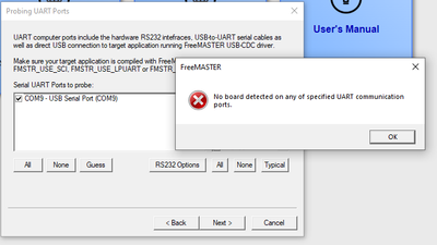

However, when I configure FreeMASTER, the setup executes without errors. But when I open FreeMASTER, it displays an error message stating that it cannot connect to UART, as shown in the message below.
Could you please help me resolve this issue? Additionally, if possible, could you provide detailed steps for setting up a basic FreeMASTER configuration? I followed the instructions mentioned in this link: How to use FreeMASTER SDKs in S32K3 RTD 0.9.0, but I am still encountering the problem shown below.
Your assistance would be greatly appreciated.

Freemaster is supported mainly here directly by our Freemaster SW developers.
Next time, I suggest you post a question on this community: https://community.nxp.com/t5/FreeMASTER/bd-p/freemaster
Thanks for understanding.
That article is outdated. I suggest you download a newer FreeMASTER Driver such as 1.3.0 RTM or 1.4.2 RFP.
Click S32K3 Standard Software -> Automotive SW - S32K3 - FreeMASTER Driver
Take 1.3.0 RTM FreeMASTER Driver as an example:
Install SW32K3_FreeMASTER_DS_updatesite_D2312.zip
Then import the example project in SW32K3_FreeMASTER_D2312.zip (...\SW32K3_FreeMASTER_D2312\examples\S32K358\fmstr_uart)
fmstr_uart_s32k358 SW32K3_FreeMASTER_D2312.pngfmstr_uart_s32k358 SW32K3_FreeMASTER_D2312.png
If the LPUART module you connect is different from the example, please modify it according to your hardware.

Thank you for providing the updated version information . I configured the LPUART in normal mode and successfully integrated it with FreeMaster using this version. While the example code didn't work as expected (I'm not sure why), the issue has been resolved, and everything is now functioning correctly with the updated driver.Thanks you
