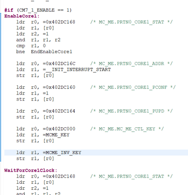

I made CM7_1_Enable as 0 in core 0 , according to the start_up file of core 0, clock for core 1 is should not enable in there.
In core 0 main file I'm trying to enable the core clock for core 1 , but before that I'm checking the core1 clock status bit , it is already enabled.

1. CM7_1_ENABLE = 0 in the IVT/boot header doesn’t guarantee the clock is gated. That flag only controls whether CM7_1 is released at boot given a start address:
.section boot_header" header","ax
.long SBAF_BOOT_MARKER /* IVT marker */
.long (CM7_0_ENABLE << CM7_0_ENABLE_SHIFT) | (CM7_1_ENABLE << CM7_1_ENABLE_SHIFT) /* Boot configuration word */
.long 0 /* Reserved */
.long CM7_0_VTOR_ADDR /* CM7_0 Start address */
.long CM7_1_VTOR_ADDR /* CM7_1 Start address */
.long XRDC_CONFIG_ADDR /* XRDC configuration pointer */
.long LF_CONFIG_ADDR /* Lifecycle configuration pointer */
 If CM7_1_ENABLE = 1: CM7_1 is enabled during boot. Debugger can connect to CM7_1 at the beginning.

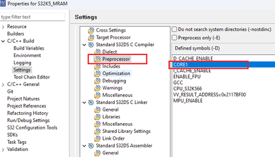

You should ensure that only the master core can initialize the clock for the MSCM module. So, check if CORE1 is defined in core1 project, and CORE0 in the core0 project.

1. I Make it CM7_1_Enable =0 , becoz i don't want to execute the following part in start up code
Becoz i want core 0 application needs to enable the core 1.
and core 0 is defined in core 0 project and core 1 is defined in core 1 project
