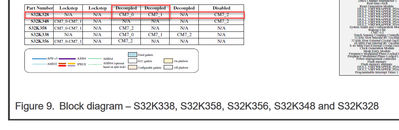

2. And we are using S32k328(Used S32K324 only for testing), in this mcu remote core is core 1 right like not in S32k358(which is core 0 and core 2).
We are using MC_ME.PRTN0_CORE1_PCONF[CCE] to enable the core 1 clock, is it same for s32k328?
Becoz in datasheet there is one more register mentioned for s32k328, I'm confused in here

2. Yes. S32K328 has CM7_0 & CM7_1 as S32K324:

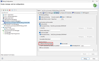

3. You could try modifying PEmicro's script and such, but for testing purposes, I suggest simply power-cycling the device and connecting through "Attach to Running Target" debug config to see if clock from core 1 is enabled:
