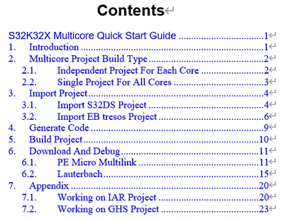

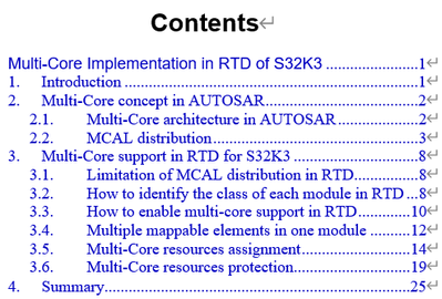

The below figures summarized the package contents:
Example Projects:
Quick Start Guide:
Multi-Core related topics:
