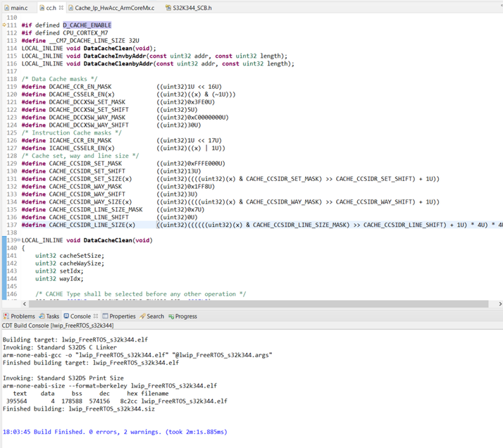

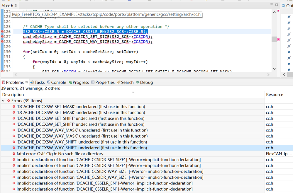

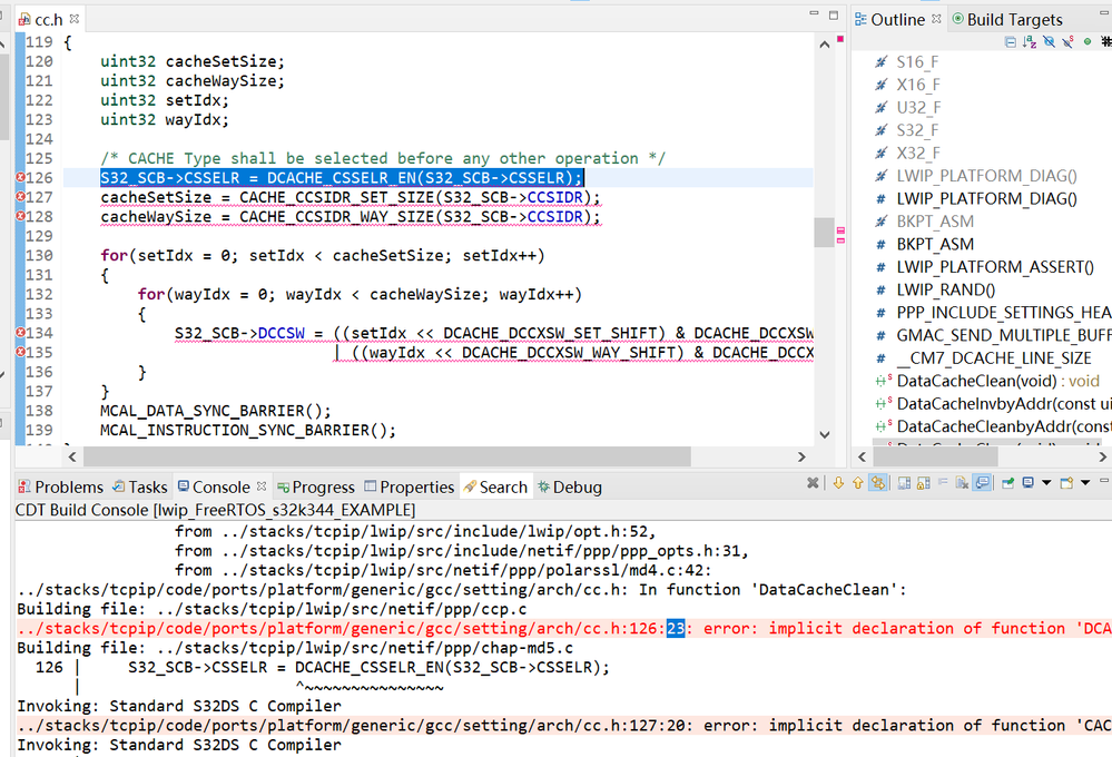

S32K344 After D_CACHE_ENABLE is enabled, the following error occurs when compiling. The cc.h file has many undefined macros

D-cache is not supported in this routine, if you want to enable D-cache, this is suggestion from SW team.
You can add some following macros:
/* Data Cache masks */
#define DCACHE_CCR_EN_MASK             ((uint32)1U << 16U)
#define DCACHE_CSSELR_EN(x)            ((uint32)((x) & (~1U)))
#define DCACHE_DCCXSW_SET_MASK         ((uint32)0x3FE0U)
#define DCACHE_DCCXSW_SET_SHIFT        ((uint32)5U)
#define DCACHE_DCCXSW_WAY_MASK         ((uint32)0xC0000000U)
#define DCACHE_DCCXSW_WAY_SHIFT        ((uint32)30U)
/* Instruction Cache masks */
#define ICACHE_CCR_EN_MASK             ((uint32)1U << 17U)
#define ICACHE_CSSELR_EN(x)            ((uint32)((x) | 1U))
/* Cache set, way and line size */
#define CACHE_CCSIDR_SET_MASK          ((uint32)0xFFFE000U)
#define CACHE_CCSIDR_SET_SHIFT         ((uint32)13U)
#define CACHE_CCSIDR_SET_SIZE(x)       ((uint32)((((uint32)(x) & CACHE_CCSIDR_SET_MASK) >> CACHE_CCSIDR_SET_SHIFT) + 1U))
#define CACHE_CCSIDR_WAY_MASK          ((uint32)0x1FF8U)
#define CACHE_CCSIDR_WAY_SHIFT         ((uint32)3U)
#define CACHE_CCSIDR_WAY_SIZE(x)       ((uint32)((((uint32)(x) & CACHE_CCSIDR_WAY_MASK) >> CACHE_CCSIDR_WAY_SHIFT) + 1U))
#define CACHE_CCSIDR_LINE_SIZE_MASK    ((uint32)0x7U)
#define CACHE_CCSIDR_LINE_SHIFT        ((uint32)0U)
#define CACHE_CCSIDR_LINE_SIZE(x)      ((uint32)((((((uint32)(x) & CACHE_CCSIDR_LINE_SIZE_MASK) >> CACHE_CCSIDR_LINE_SHIFT) + 1U) * 4U) * 4U))

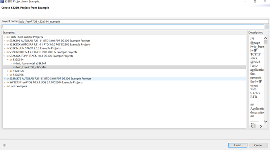

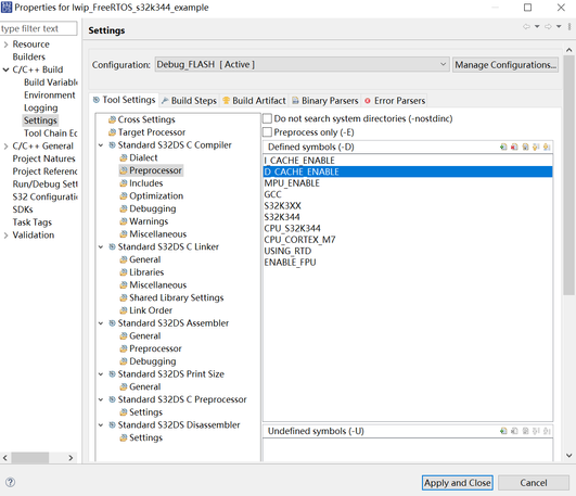

Senlent
Hi@harryoceana
Could  you please describe clearly where the demo you are using comes from, what its name is, and what modifications you have made to it, so that we can reproduce the problem.
3,378 次查看
harryoceana
This is LWIP example, Only the D_CACHE_ENABLE definition was added .
