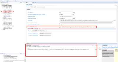

As shown below, when I do not configure the EcuM WakeUP Source, an error is reported at compile time in the red box below
But when I add the EcuM module (add the WakeUP source) and it turns on the EcuM WakeUP Source, the error disappears
I don't want to use Ecum module, and I don't want to turn on LIN wake up function, how should I configure, I don't know what to do

Hello @ananan ,
This is a limitation in the MCAL_4.3_RTM_1.0.1. Could you please try the newest version MCAL_4.3_RTM_1.0.2.
Hung.
