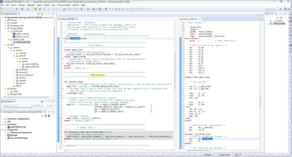

First, I suggest you look at the several situations mentioned in Fault handling on S32K14x.
In addition, have you disable the watchdog? The S32K1 SDK disabled the watchdog by default.

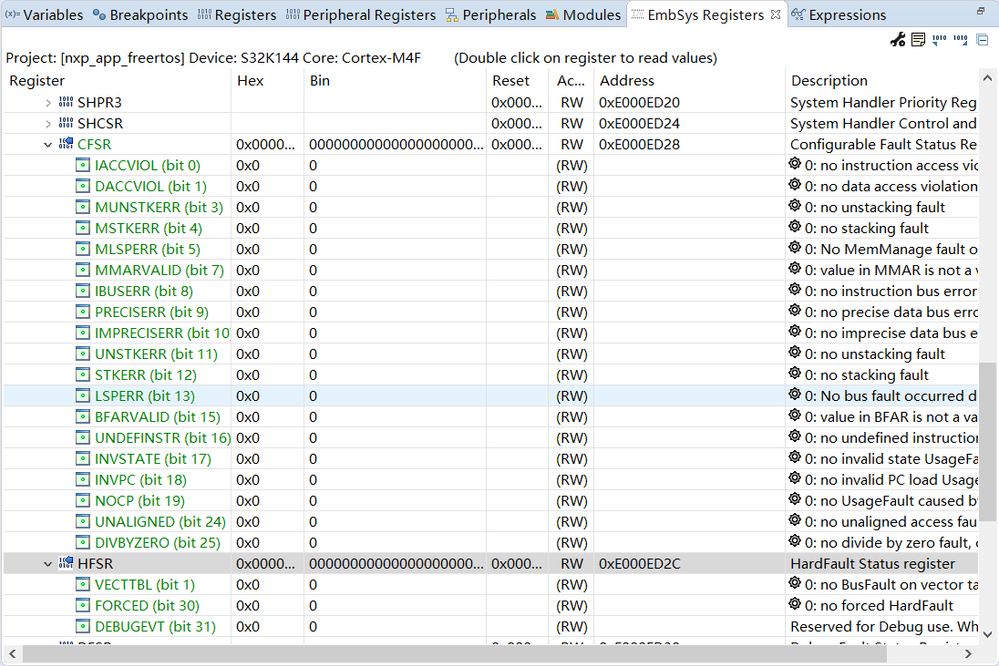

TanTianLong
When my program jumps from bootloader to this app program, the program enters defaultISR, I find the CFSR register, all values are 0, I don't know what error is caused
After my program stopped at DefaultISR, I open the "Disassembly" window and see that it's parked hereAfter my program stopped at DefaultISR, I open the "Disassembly" window and see that it's parked heredefaultISRProblem2.pngdefaultISRProblem2.png

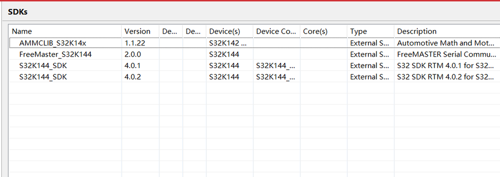

TanTianLong
Hi,@Robin_Shen
I used s32ds 2.2+RTM3.0 before, but I downloaded S32DS 3.4+RTM4.0, and there were some problems when compiling the program. I configured the peripherals and pins using software before, do I need to reconfigure now?
2,821件の閲覧回数
Robin_Shen
Using S32K1 SDK 3.0.x projects in S32DS v3.4 will encounter errors. Have a look at Video: Migrating S32K1 projects from S32DS for ARM and SDK 3.0.x to S32DS 3.4 and SDK 4.0.2

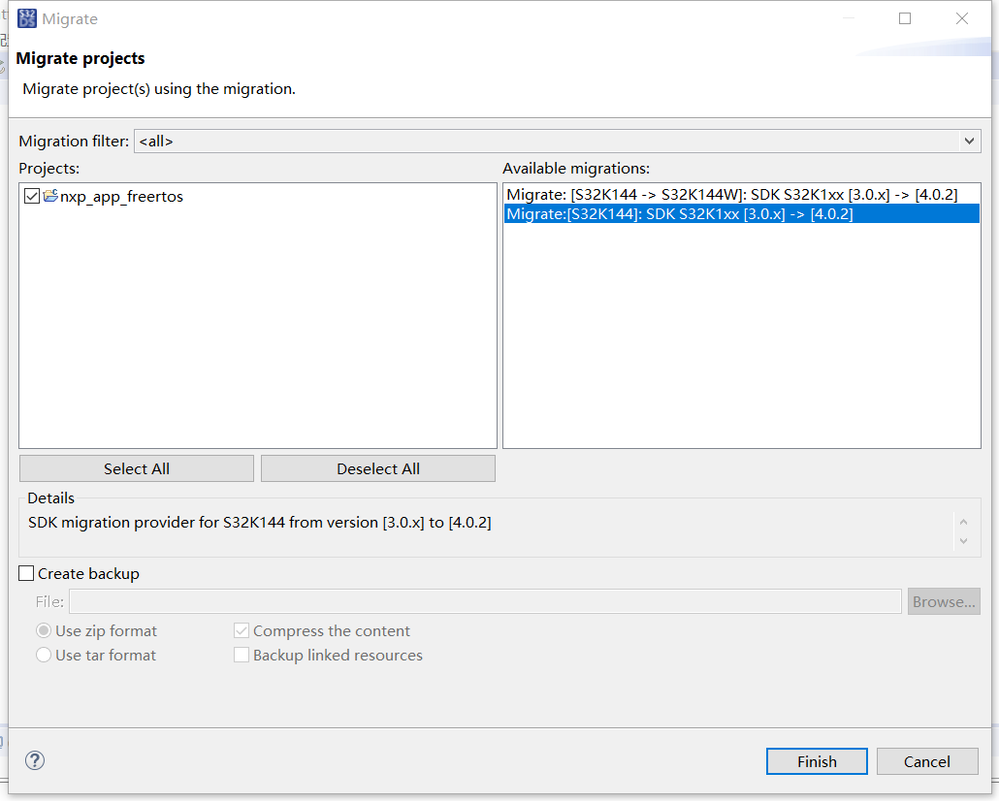

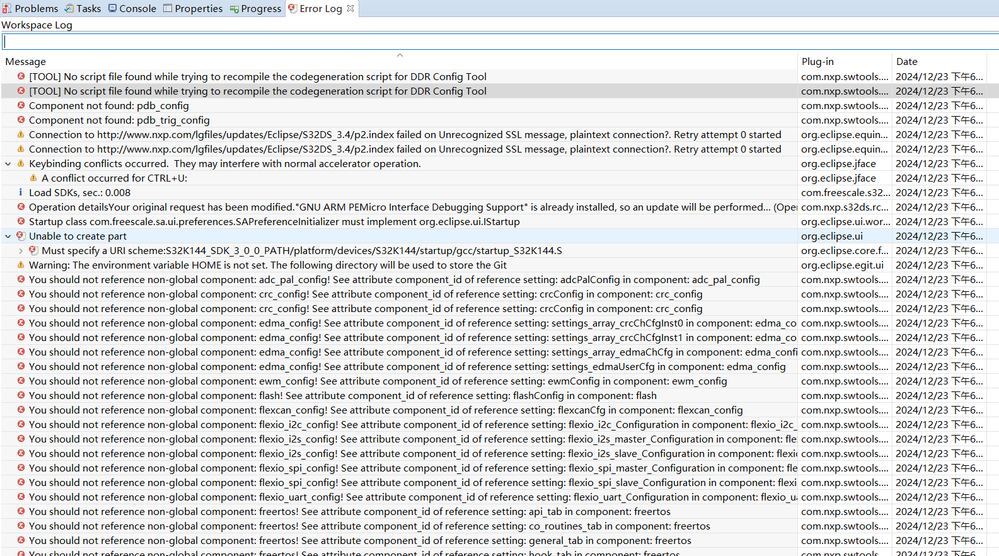

Hi @Robin_Shen
I followed the steps in the video, but nothing changed after opening the config
s32ds3.4ProblemMigrate1.pngs32ds3.4ProblemMigrate1.pngs32ds3.4ProblemMigrate2.pngs32ds3.4ProblemMigrate2.png
