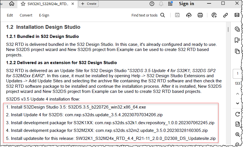

The release notes of S32K RTD usually mention which dependent software packages need to be installed. Taking SW32K1_S32M24x_RTD_R21-11_2.0.0_P04_D2404_ReleaseNotes.pdf
as an example, we can see that the following software packages need to be installed:
SW32K1_S32M24x_RTD_R21-11_2.0.0_P04_D2404_ReleaseNotes 1.2 Installation Design Studio.png

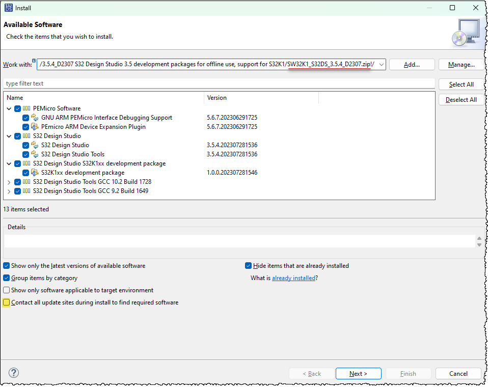

3. Download and Install S32 Design Studio 3.5 development packages for offline use, support for S32K1 (3.5.4_D2307): SW32K1_S32DS_3.5.4_D2307.zip  (com.nxp.s32ds.s32k1.dev.repository_1.0.0.202307062245.zip)

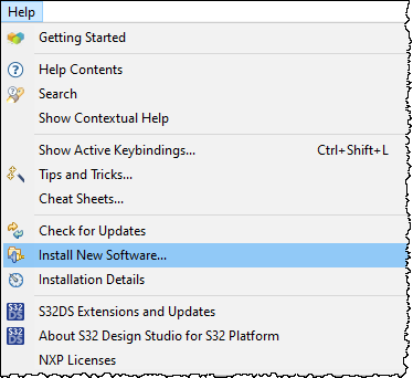

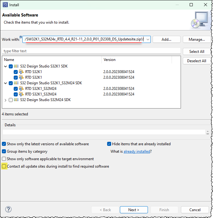

Unchecking Contact all update sites during install to find required software can complete offline installation faster.

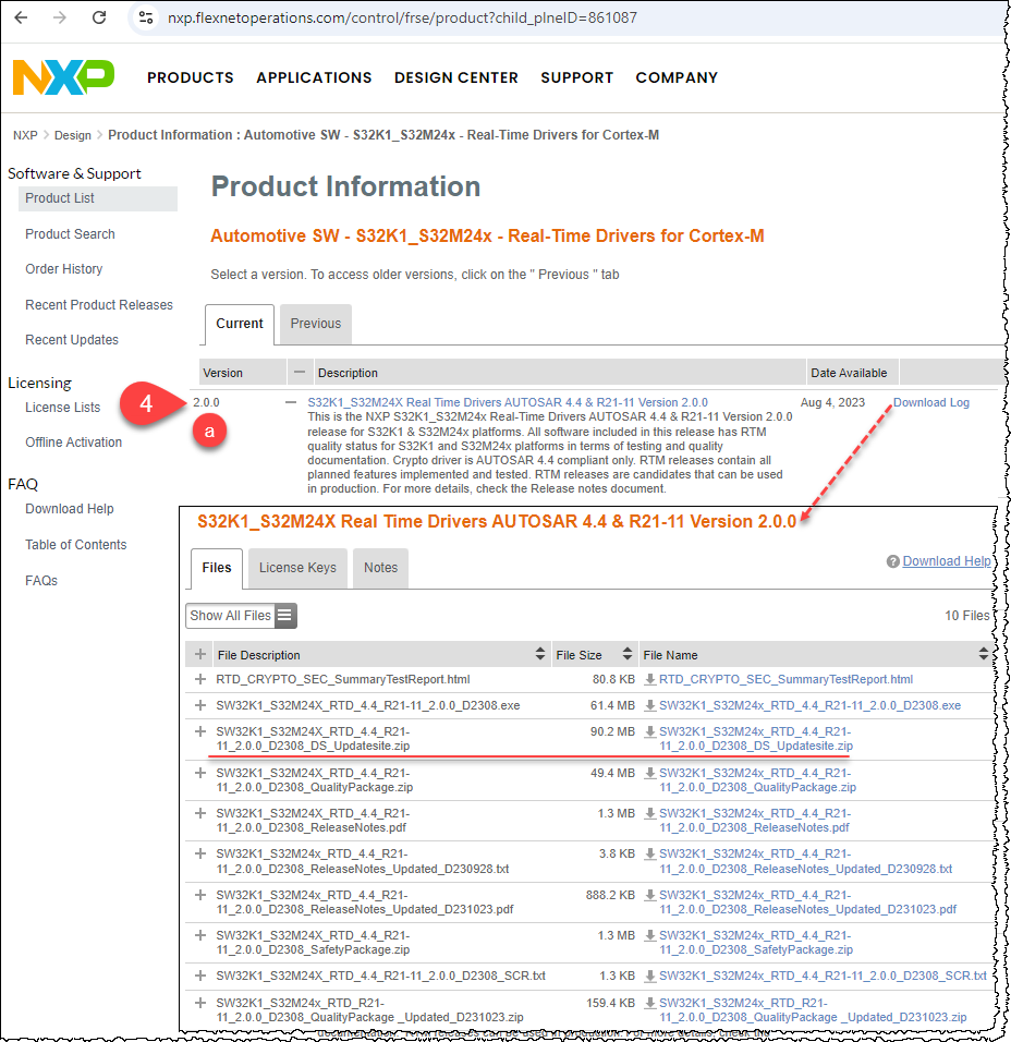

4. Click Real-Time Drivers for S32K1 -> Automotive SW - EB tresos Studio / AUTOSAR Configuration Tool
Select and install one of the following updatesite.zip for S32K1 RTD 2.0.0:
The latest S32K1 RTD version is usually recommended. However, if you need to use Reference Software or Premium Software (such as FreeRTOS, LIN Stack, TCP/IP Stack Structural , Core Self-Test (SCST), Automotive Math and Motor Control Library (AMMCLib), S32K ISELED), it is recommended to install the specific version of S32K1 RTD according to their release notes.

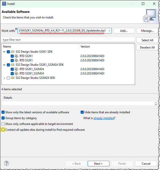

4.a) Download and install S32K1_S32M24X Real Time Drivers AUTOSAR 4.4 & R21-11 Version 2.0.0: SW32K1_S32M24x_RTD_4.4_R21-11_2.0.0_D2308_DS_Updatesite.zip
step4. Download SW32K1_S32M24x_RTD_4.4_R21-11_2.0.0_D2308_DS_Updatesite.zip.png

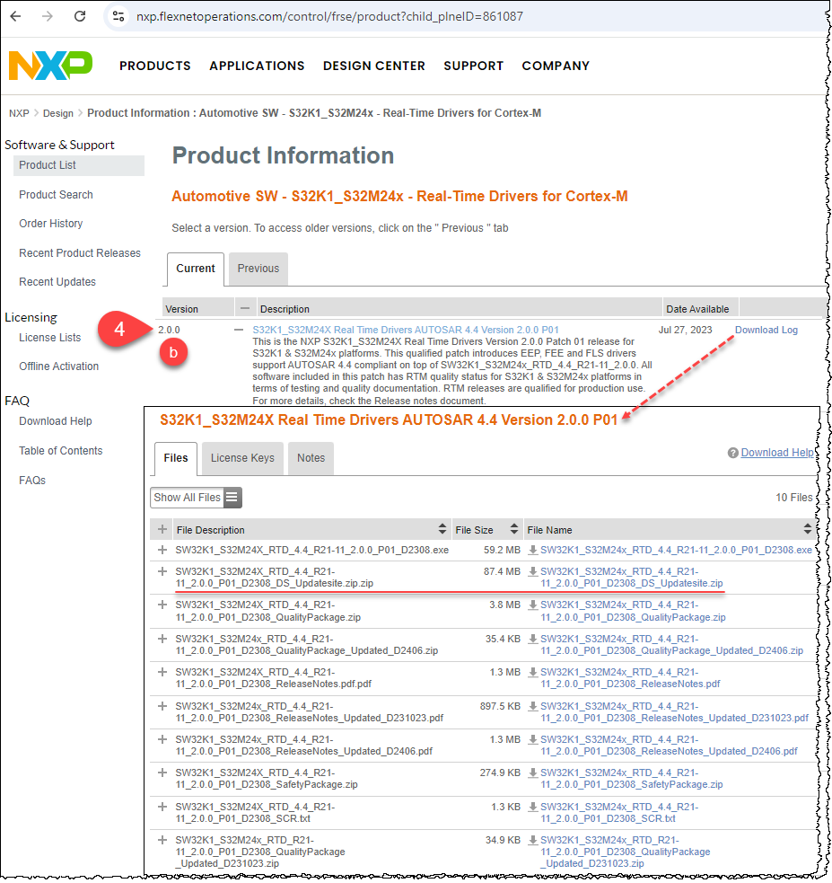

4.b) Download and install S32K1_S32M24X Real Time Drivers AUTOSAR 4.4 Version 2.0.0 P01: SW32K1_S32M24x_RTD_4.4_R21-11_2.0.0_P01_D2308_DS_Updatesite.zip
step4. Download SW32K1_S32M24x_RTD_4.4_R21-11_2.0.0_P01_D2308_DS_Updatesite.zip.png

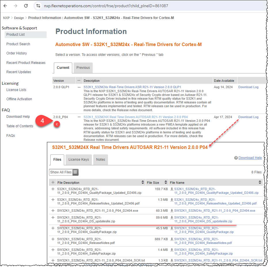

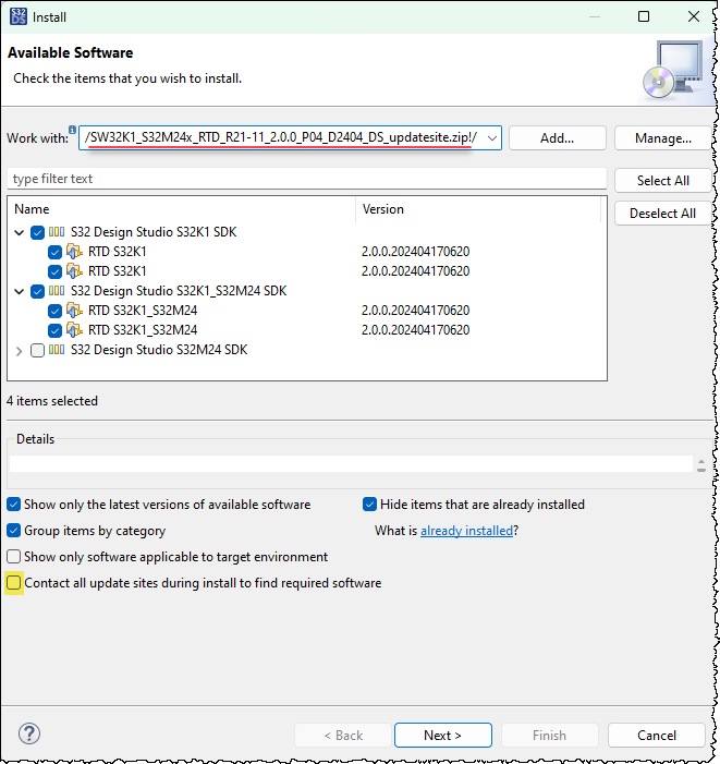

4.c) Download and install S32K1_S32M24X Real Time Drivers AUTOSAR R21-11 Version 2.0.0 P04: SW32K1_S32M24x_RTD_R21-11_2.0.0_P04_D2404_DS_updatesite.zip
