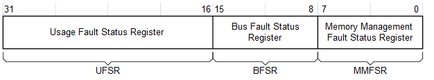

Status and address registers for fault exceptions
Configurable Fault Status Register (CSFR) consists from three status bit fields for Usage Fault (UFSR), Bus Fault (BFSR), and Memory Management Fault (MMFSR) where each bit represents a fault exception.
There are also two auxiliary address registers. If BFARVALID is set in the BFSR register, Bus Fault Address Register (BFAR) holds the memory access location of a precise bus fault. Similarly, if MMARVALID bit is set in MMFSR register, Memory Manage Address Register (MMAR) holds the address of a MemManage fault.

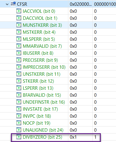

The CSFR register is read to determine which exception has occurred and, if available, the memory access location that has caused the exception.

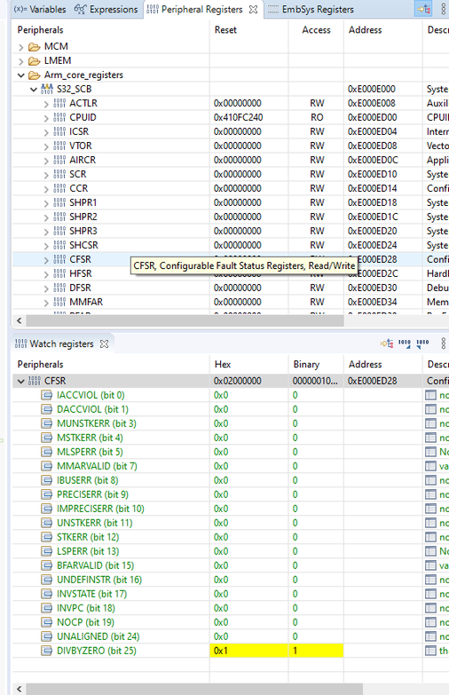

Hello, Thank you for the example code.
I have some questions please:
1. will this example work also with s32k142 without changing anything on fault_exceptions.c and fault_exceptions.h

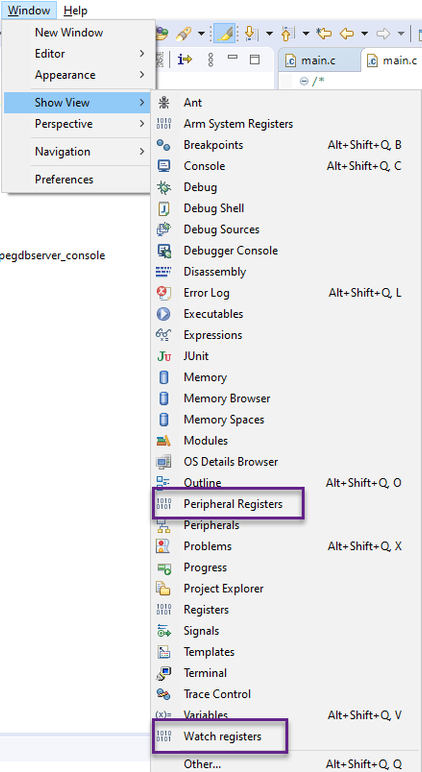

2. how can it be tested, because i tested the division by zero, but it doesn't go to the handler, instead it went to 0x0 address.
3. Where i can fine CSFR register, i couldn't find it in any of the "peripheral register" window from s32ds
Thank you
Hi @elb1,
1. Yes, it works with the S32K142 derivative too.
2. Do you call the enable_div_by_zero_trap()? Without it the result of the division would be 0.
3. In S32DS 3.4 and 3.5, use the Peripheral Registers view.

@danielmartynek hello,In S32DS 3.4,s32k144, I cannot find the arm core register term in Peripheral Registers, but there be an Arm System Registers, and I still cannot see anything when i click into it, what should i do next ?
THANKS
