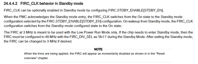

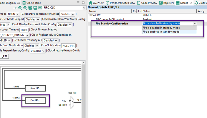

Not sure what the issue is, but I understand you want to keep the FIRC running while the MCU is in the Standby mode (Power_Ip_SetMode(&Power_Ip_aModeConfigPB[2U])).
The FIRC must be enabled in the Standby mode first.
It is disabled in teh project.

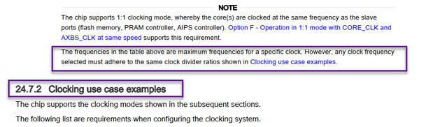

  • The FIRC clock must be configured to 48 MHz during the RUN - STANDBY transition:
  • The system clock must be configured to on of the examples in the RM, Section 24.7.2 Clocking use case examples. The examples can be changed, however, the divider ratio must be maintained.
