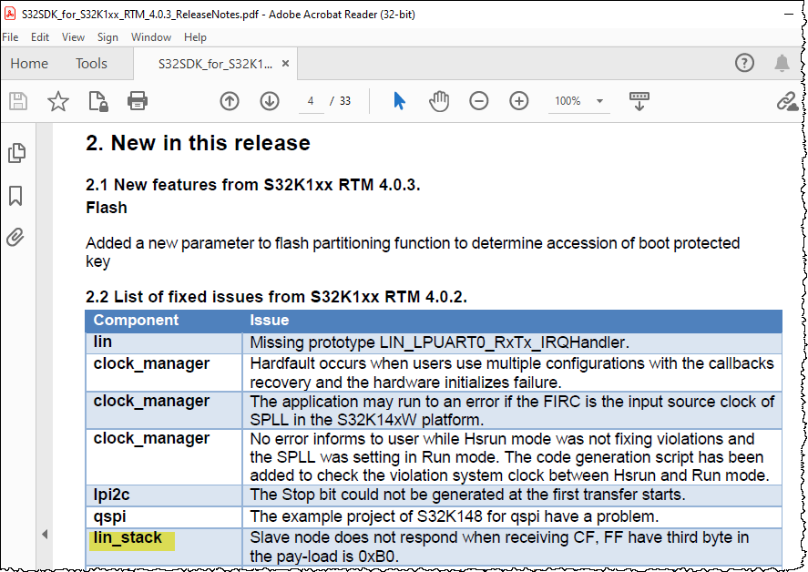

According to the currently available information, we don’t have any plan to integrate S32SDK S32K1XX 4.0.3 into S32DS 3.5 or above version.
Sorry, do you mean the lin_stack mentioned in chapter 2.2 List of fixed issues from S32K1xx RTM 4.0.2.? If so, it's fixed in S32K1xx RTM 4.0.3 + S32DS v3.4 .
If not, would you please submit a new question in S32DS community. So that S32DS experts can help you check the issue.

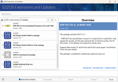

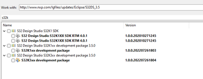

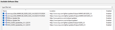

I use S32DS 3.5 (latest version). I installed SDK RTM 4.01 with "S32DS Etensions and Updates".
I don't see any 4.03 update
See my screen
When I uninstall and try to reinstall, only version 4.0.1 is available. What to do for S32DS 3.5 (latest version)
See my update sites:
And when I try to make "Eclipse >Help > Install new software", I don't find other versions than 4.0.1
