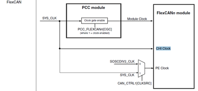

5,433 次查看
Julián_AragónM
Hi @Prasad_330,
The FlexCAN protocol clock needs to be configured as the peripheral clock:
Please refer to chapter 73.3.10.8 Protocol timing from the S32K3XX's reference manual.
Julián
