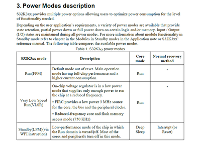

I am working on s32k324 VLSR mode.
I have changed the clock to FIRC, But i am not able to make the CORE_CLK to 3MHZ.  Because the FIRC = 48MHZ  clock divider max value is only 8. so core clock = 48MHZ/8  is equal to 6MHZ.
How to change into 3MHZ.
I also wanted to know what are the module that can be used in the VLSR. I wanted use CAN and UART in VLSR mode.
how to change the "FlexCanProtocol clock" to 3MHZ
Can you plz help me out.

Hi @Prasad_330,
You can select the frequency for Fast IRC from the Clocks Diagram:
And for the peripherals, please go into "Peripheral Clock View" and the source clock for each peripheral can be selected:
Julián

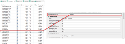

Prasad_330
hi Julian_AragonM
Thanks for the reply,
I have configured the clock configuration and Peripheral Clock View  as suggested by you.
But my FlexCAN configuration is configured as below snapshot and it is working properly in the RUN mode
where my FlexCAN Protocal Clock is 25000000(25Mhz).
Now in VLSR mode if I change the clock of FlexCAN  to 3000000(3Mhz), should want to do any changes in the bitrate (kbps). if  so, then how to configure.
I am getting the bus_error in VLSR mode.
Plz let me know any other configuration I am missing.
5,585件の閲覧回数
Julián_AragónM
Hi @Prasad_330,
The FlexCAN protocol clock needs to be configured as the peripheral clock:
Please refer to chapter 73.3.10.8 Protocol timing from the S32K3XX's reference manual.
Julián
