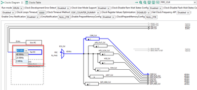

I am working on s32k324 VLSR mode.
I have changed the clock to FIRC, But i am not able to make the CORE_CLK to 3MHZ.  Because the FIRC = 48MHZ  clock divider max value is only 8. so core clock = 48MHZ/8  is equal to 6MHZ.
How to change into 3MHZ.

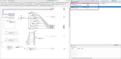

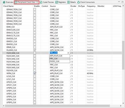

Julián_AragónM
Hi @Prasad_330,
You can select the frequency for Fast IRC from the Clocks Diagram:
And for the peripherals, please go into "Peripheral Clock View" and the source clock for each peripheral can be selected:

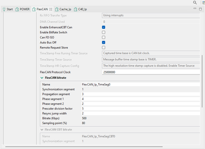

I have configured the clock configuration and Peripheral Clock View  as suggested by you.
But my FlexCAN configuration is configured as below snapshot and it is working properly in the RUN mode
where my FlexCAN Protocal Clock is 25000000(25Mhz).
Now in VLSR mode if I change the clock of FlexCAN  to 3000000(3Mhz), should want to do any changes in the bitrate (kbps). if  so, then how to configure.
I am getting the bus_error in VLSR mode.
Plz let me know any other configuration I am missing.

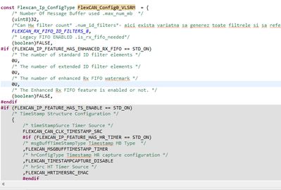

Prasad_330
Hi Julian
we are working on s32k324 very Low speed run mode for CAN
To enter into VLSR mode from the RUN mode, I am changing the CLOCK to 3Mhz.
Before changing the clock i am de_initializing the CAN.
after changing the clock to 3MHZ ,I am reinitializing the CAN with 3Mhz
The structure (above )"FlexCAN_Config0_VLSRM"  is created by me.
It is copied from the other project where  Flex CAN Protocol Clock is equal to 3MHZ and bitrate is equal to 500Kbps.
In the RUN mode CAN Tx and RX is working fine.
In the VLSR mode
For CAN transmission we getting the return value as "FLEXCAN_STATUS_SUCCESS" for the ever first  time and from next cycle we are getting "FLEXCAN_STATUS_TIMEOUT" and also we are not getting any bus error.
But  if CAN transmission is done @100 ms interval from external environment to the s32k324 (using CAN Analyzer) most of the time we get  the return value as "FLEXCAN_STATUS_SUCCESS"  and randomly we are getting the CAN interrupt, which we have to get for every 100ms.
I have also attached the stand alone code for CAN VLSR mode.
Plz let me know any other parameter should be taken care
5,184件の閲覧回数
Julián_AragónM
Hi @Prasad_330,
It seems like my colleague has already answered your post: S32k324 VLSR mode - NXP Community. Please check your bit timing parameters for the FlexCAN module.
