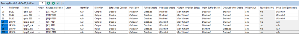

I'm configuring the pins for LPSPI0 like below.
How can I find the drive strength setting for each pin in the source code or Design Studio?
In Design Studio, it is impossible to set the driver strength.
Are there any options to set this? These pins just set as defined in the datasheet?
ex) PTE4: Standard, PTE1: Standard, PTE0: Standard, PTE2: Standard

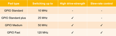

The pins that support High-Drive strength depend on the pad type. As you mentioned, all the LPSPI pins selected are standard and do not support it, so it is not possible to enable it in the Pin Tool.
