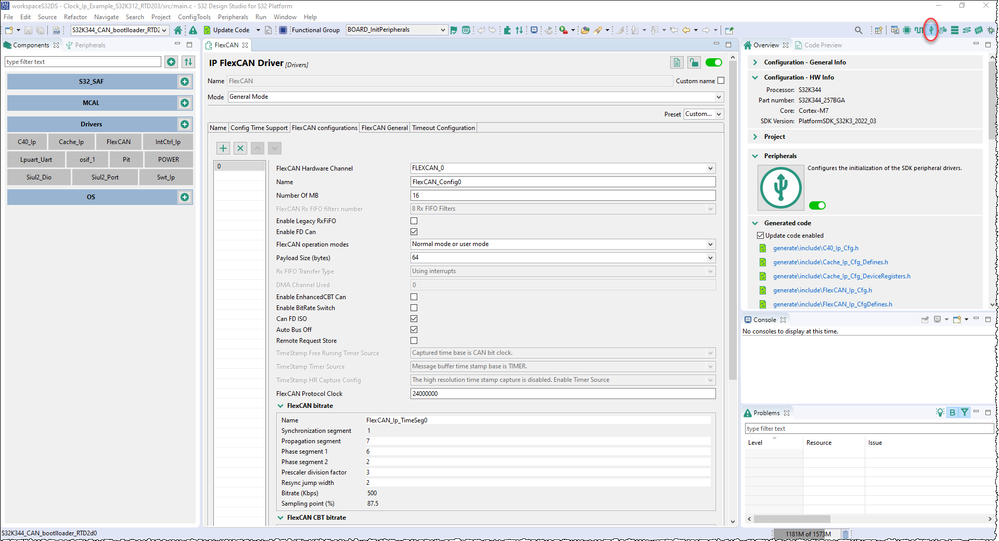

I am using S32K344 TBOX and I want to implement unified can bootloader sample "S32K344_CAN_Bootloader_RTD2d0". I have installed S32K3 RTD AUTOSAR 4.4 Version 2.0.0, the program compile with no errors and warnings:
I have connected 3 Peak Can 2, 4 and 5 but in the sample the output is configured for output 0. I don´t have Tresos project to change it and generate the new configuration. How can I do it?

CAN0 of S32K3-T-BOX is connect to J33 pin 4(CAN0_H) and pin 14(CAN0_L).
You don't need EB tresos Studio, you should be able to change the configuration of S32K344_CAN_Bootloader_RTD2d0 in S32CT Configuration Tool.
S32K344_CAN_bootlloader_RTD2d0 S32 Configuration Tool.pngS32K344_CAN_bootlloader_RTD2d0 S32 Configuration Tool.png
