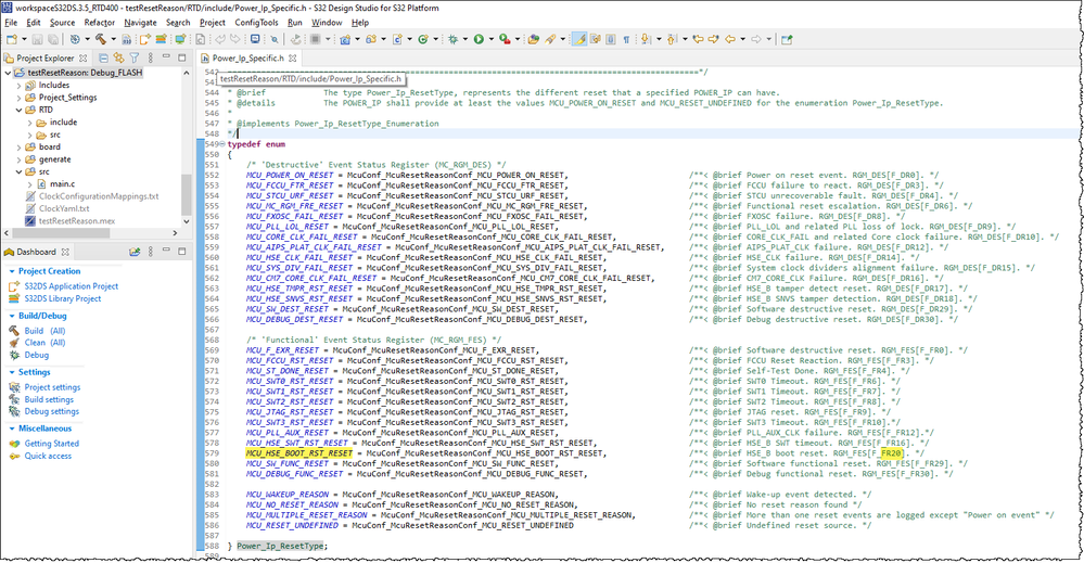

I'm not sure which S32K3 RTD version you are using. I am using S32K3 RTD 4.0.0 and I did not find Core lockup error or Memory ECC error.

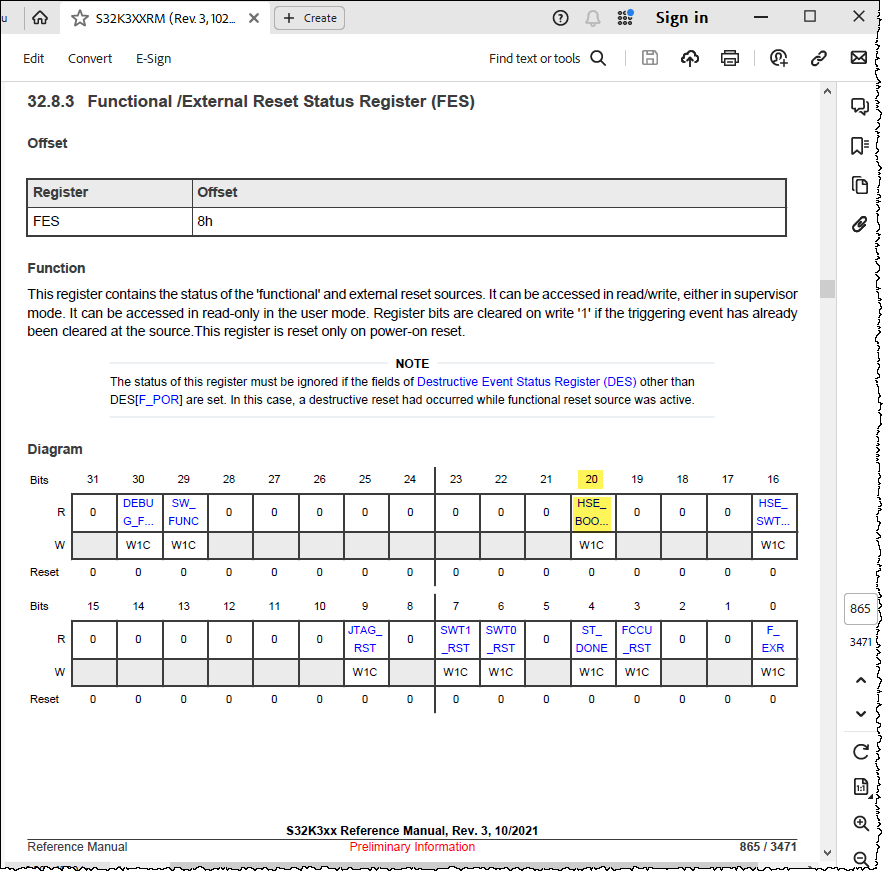

Take MCU_HSE_BOOT_RST_RESET as an example, /**< @brief HSE_B boot reset. RGM_FES[F_FR20]. */
F_FR20 here refers to bit 20[HSE_BOOT_RST] of Functional/External Reset Status Register (FES).
Functional External Reset Status Register (FES).pngFunctional External Reset Status Register (FES).png
