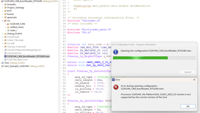

Thank you for the example set, however, with the latest S32DS IDE the mex file gives an error that the platform is not compatible and it seems that it is not possible to install the old platform in the new S32DS IDE.
Would you be so kind to update the platform to the latest version to be able to import it?
Thank you in advance for your time and consideration.

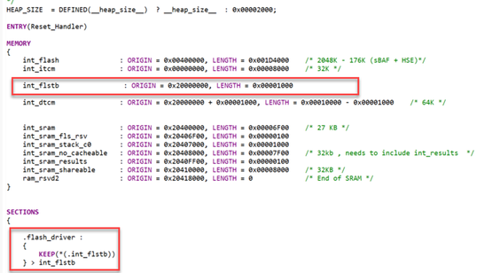

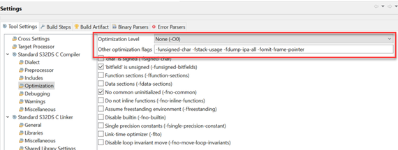

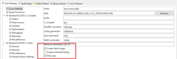

Some users are looking for the flash driver source project of this routine, I summarize the process of making it as follows:
(you need to create a new project and add C40_Ip component to your project)
1.set Optimization Level to None
2.create flash image->HEX
3.modified the linker file.
4.copy and attribute "C40_Ip_StartSequence"

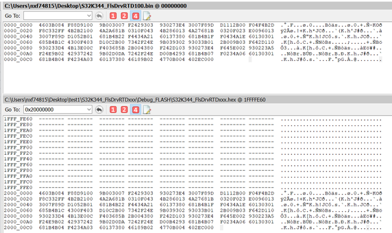

The above is the generation process of the flash driver for this routine, which is actually only a function "C40_Ip_StartSequence".
The bin content generated by the test is same

I also want to add additional questions to @JonAnder_Amante.
Why do you use DTCM instead of SRAM?
How can we adjust other (bootloader and app) linker files if we change flash driver as shown?

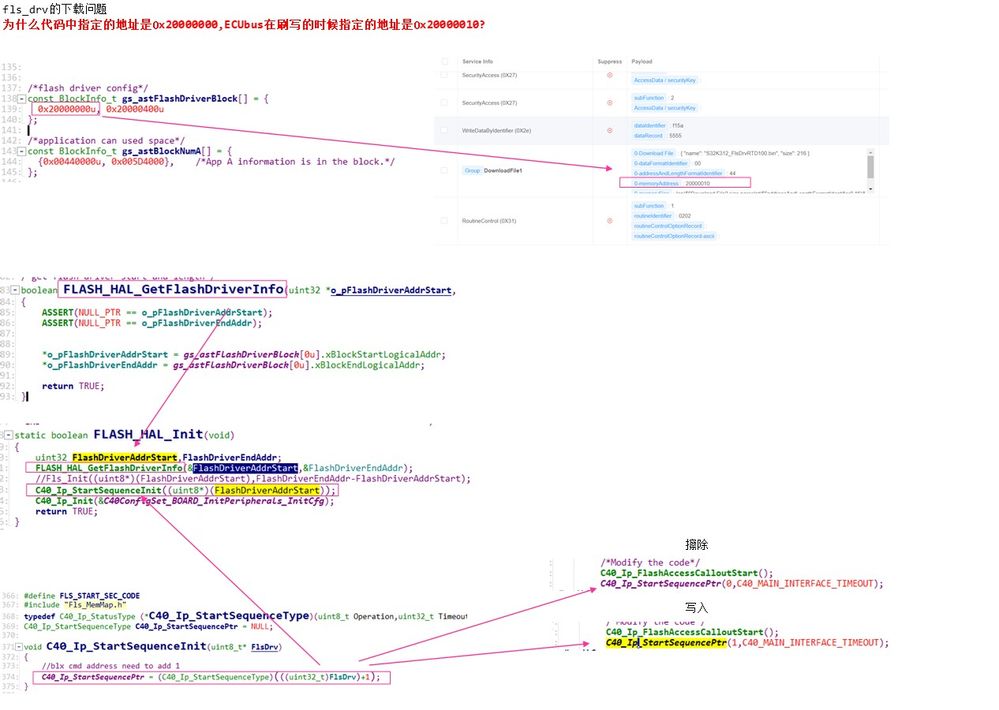

#S32K312 #ECUBUS
I'm using ecubus to do s32k312 bootloader,I haven't figured out the flash_driver of the separate code,Look at the code given by the nxp official and the ecubus project,I found that the address selected when brushing the flash_driver is 0x20000010,But the code and LD are 0x20000000,Why is there this deviation?

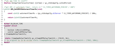

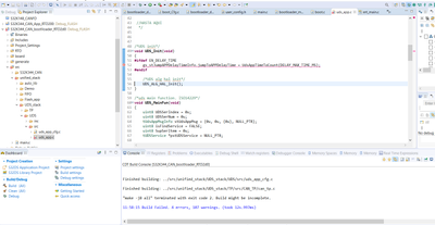

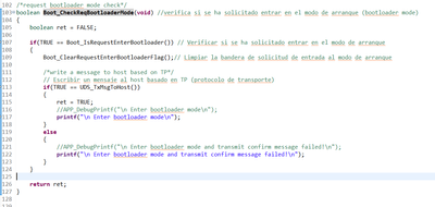

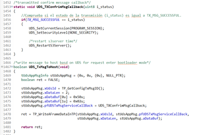

- Report Inappropriate Content

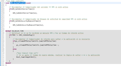

Hi, I am using the project "S32K344_Can_bootloader_RTD200" in the microprocessor S32K344. I want to download an application with the program of bootloader. I have achieved the jump from program to application but I have different questions. 1. I want to use #define EN_DELAY_TIME but when I uncomment the command in the folder "public_in", the program has different errors. My target to use "Backdoor", that is to say, I want to check if the program has to enter to bootloader or not. I don´t know the process and the different functions that I have to use to achieve the target. I want to use the function "Boot_CheckReqBootloaderMode(void)" but when I debug the program, it never enters to the "if". Could you explain me the process and the steps to achieve the target. I add different functions that I think are important. 2. I don´t know if I have to modificate the parameters of "static tJumpAppDelayTimeInfo gs_stJumpAPPDelayTimeInfo = {FALSE, 0u};". I have to change this structure ? You can see all structure in one of the next pictures. I need the reply as soon as possible since I have to send a project very soon.
Thank you for all,

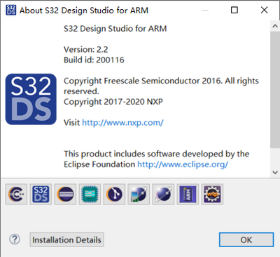

Hello, where is the C40_Ip component , I cann't find it. this is the IDE I am using
@xierxiaofeng you need to install RTD 2.0.0
