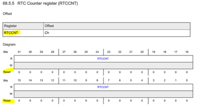

Hello all,
I am currently using S32K344 with MCAL libraries. I can succesfully generate interrupt for every seconds however my main purpose is to set and read time and i can not find the commands to do the trick.
Is there any example of reading and setting time using MCAL functions?
My other question is: Does the device reset RTC domain when device is resetted or the device keeps on counting the RTC?
Thank you,

cuongnguyenphu
Can you describe detail about your purpose to use RTC on S32K344 in state "my main purpose is to set and read time"
What is your input and expectation?
Does the device reset RTC domain when device is resetted or the device keeps on counting the RTC? RTC counter will reset to 0 when resetting.
