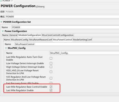

Regarding using the VRC_CTRL function, I understand that I need to refer to section 43.7.3 (PMC Configuration Register (CONFIG)).
1.But how do I configure it when using the S32DS tool? Do I just need to check the two options in the picture below?
2.How do I verify that the configuration is correct? Is the output of VRC_CTRL 1.5V? Will this output be maintained during the function reset process? Will it not be maintained when entering Standby?

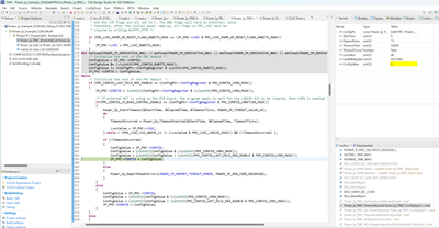

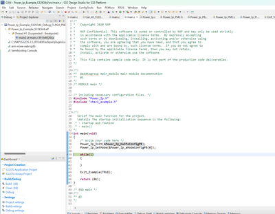

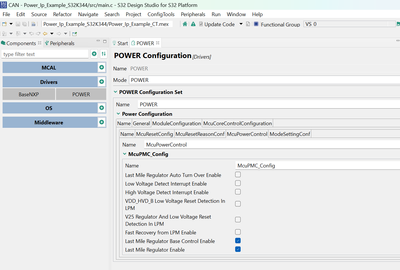

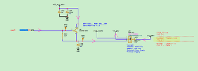

      1. Hardware side, you need to change the S32K344 EVB ,J31 connect 2-3, as I know, the default is using FS26_VCORE method.
2. About the VRC_CTRL code
You can run the RTD Power_Ip_Example_S32K344, it also contains the LLD POWER module, I run it, and also call Power_Ip_Init(&Power_Ip_HwIPsConfigPB);
It works OK:
The LLD POWER configuration is also like you:
So, please try my suggest hardware method, and the project, add the code and test it again.
