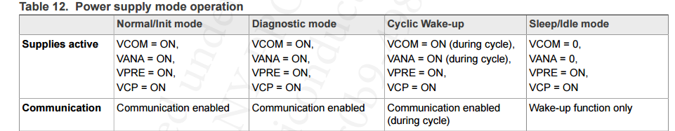

D1 LED\RED (VCOM_PRIM) on the RD772BJBTPL8EVB board is not light? The engineer responsible for MC33772C told me that it looks like the MC33772C is in Sleep/Idle mode:
Also, which debugger are you using? Perhaps you can use the following method to observe which step the program is running to: Connecting to a running Target (attach) with S32 Design Studio for S32 Platform 3.3
