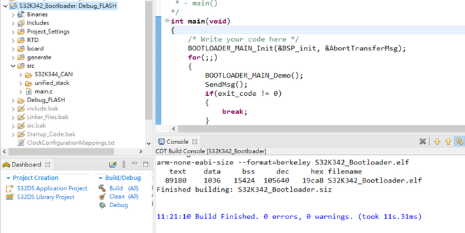

I am working on S32K342 CAN bootloader,I have refered the sample code S32K344_CAN_Bootloader_RTD2d0 in
https://community.nxp.com/t5/S32K-Knowledge-Base/Unified-bootloader-Demo/ta-p/1423099
, but I got the complier error below, Mcal.h didn't exist in my project, How can this problem be resolved? My IDE is RTD v2.0.3. Thanks!

     It's might be compatibility problem of RTD2.0 with RTD2.0.3. Suggestion you can
1. create another project over RTD2.0.3
2. Configure peripherals reference bootloader project
3. Copy all bootloader code including link file to new project without RTD and generate code
4. Compare two projects and new project code should the same with old project
5. C40_IP.c should follow old project

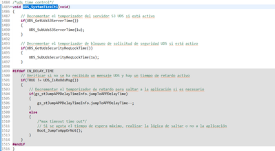

I am using the project "S32K344_Can_bootloader_RTD200" in the microprocessor S32K344. I want to download an application with the program of bootloader. I have achieved the jump from program to application but I have different questions.
1. I want to use #define EN_DELAY_TIME but when I uncomment the command in the folder "public_inc", the program has different errors. My target to use "Backdoor", that is to say, I want to check if the program has to enter to bootloader or not. I don´t know the process and the different functions that I have to use to achieve the target. I want to use the function "Boot_CheckReqBootloaderMode(void)" but when I debug the program, it never enters to the "if". Could you explain me the process and the steps to achieve the target. I add different functions that I think are important.
2. I don´t know if I have to modificate the parameters of "static tJumpAppDelayTimeInfo gs_stJumpAPPDelayTimeInfo = {FALSE, 0u};". I have to change this structure ? You can see all structure in one of the next pictures.

nxf10035
Hi, @JonAnder_Amante
   The DELAY_MAX_TIME_MS is used to, enter bootloader mode and have not received any UDS commands, if waiting DELAY_MAX_TIME_MS timeout, then jump to APP if APP is valid. You un-need to modify the global variable or content.

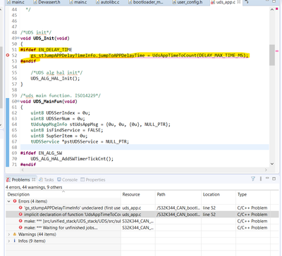

JonAnder_Amante

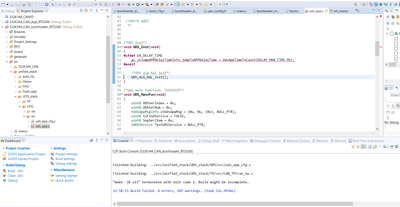

I have a problem when I try to use "#define EN_DELAY_TIME", if I uncomment this command I have different errors and I don´t know how solve the problem. I don´t the reason of error, could you give solve my question as soon as possible because I have to send the project very soon.

nxf10035
    I checked the code. The error maybe we have not used feature in new bootloader version. So, always disable the macro. If you want to enable the feature, suggestion:
1. Create a new function in uds_app_cfg.c
 void  UDS_Cfg_Init(void)
#ifdef EN_DELAY_TIME
gs_stJumpAPPDelayTimeInfo.jumpToAPPDelayTime = UdsAppTimeToCount(DELAY_MAX_TIME_MS);
#endif
2.  UDS_Init
   -Remove the code
     #endif
 - Call UDS_Cfg_Init(); in UDS_Init
Hope this can help you!

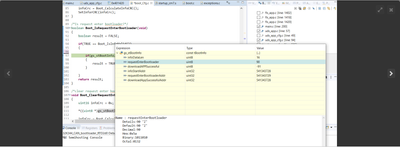

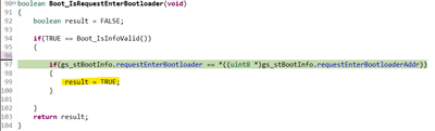

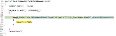

JonAnder_Amante

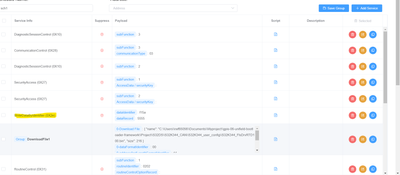

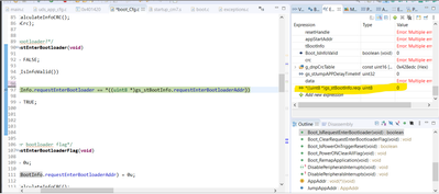

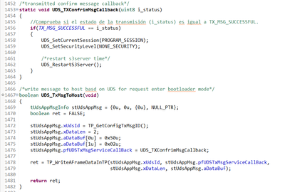

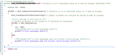

At now I dont´t receive the error of implementation but I have different questions about this. I don´t know how I can send the request to enter to bootloader. I have looked and I have seen that in my program the function "if(gs_stBootInfo.requestEnterBootloader == *((uint8*)gs_stBootInfo.requestEnterBootloaderAddr))" never is True so I think that I have a problem in this function. I also send you the value of these parameters. Maybe the configuration is done from "ECUBUS" application but I don´t know how send the request of bootloader (I have also sent you the picture of the ECUBUS because perhaps I have to do some configuration in ECUBUS).
I need your reply as soon as possible because I have to send the project very soon.
Thank you for all,
JonAnder_Amante_11-1713856619875.pngJonAnder_Amante_12-1713856701038.pngJonAnder_Amante_13-1713856737649.png
19,439 Views
nxf10035
    ECU-BUS send the UDS command (0x10 0x02) will trigger the APP reset and enter bootloader. If only have bootloader in MCU, then the bootloader will not reset.
Tomlin

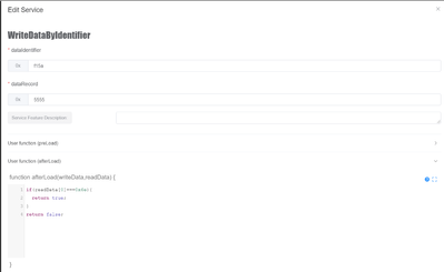

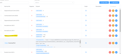

JonAnder_Amante
1. I don´t understand what you have explained me so could you tell me the steps to achieve that this function to be True "if(gs_stBootInfo.requestEnterBootloader == *((uint8*)gs_stBootInfo.requestEnterBootloaderAddr))".
2. Moreover, coould you tell me how I can send the request of bootloader because I don´t know how to do it.
3. Finally, could you tell me the purpose to send the service "WriteDataByIdentifer". I send you different pictures again.

nxf10035
Tomlin

Thanks for previous advice, I have already build successfully on S32K342 MCU using S32K344 CAN bootloader sample code, FW could be programmed into MCU too.

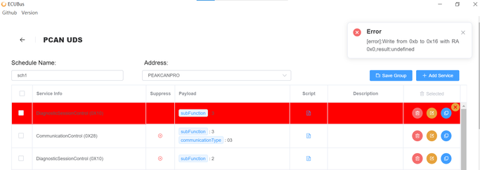

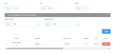

But I encounter another problem now. I have connected PEAK CAN donggle to GUI ECUBus.
I import the ECUBUS_344CAN_uds.json to PCAN UDS schedule from sample file: S32K3xx\S32K344_CAN\
When I click "start" on GUI, there is an error below show : Write from 0xb to 0x16 with RA 0x0,result:undefined
How can i solve this problem? Thanks!
Harry
22,142 Views
nxf10035
Hi, @HarrySu ,
   Did you config the CAN info as following?
Tomlin
22,106 Views

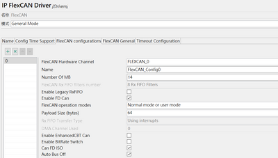

HarrySu
Hello Tom @nxf10035 ,
Thanks for your reply, my CAN config setting is below, I followed the PDF:ECU-Bus User Guide page4 setting.
About config setting on S32K342, I have an one different setting from S32K344 CAN boot loader.
In below picture, Number Of MB :14, 14 is the maximum value that I can set in S32K342.
But S32K344 set Number Of MB :16, will it cause any error on CAN communication?
Harry
22,099 Views
nxf10035
Hi, @HarrySu

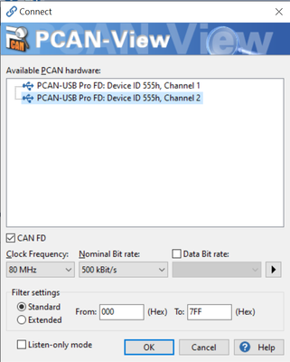

  We just test on PCAN-USB Pro. What's your hardware type? I think you can send UDS message(0x02 0x10 0x03) to verify the hardware and bootloader working  normally or not in GUI.
Tomlin

HarrySu
This is my PEAK CAN Pro HW type:
https://www.microport.com.tw/prod/CAN-Bus-%E6%8E%A7%E5%88%B6%E5%99%A8%E5%8D%80%E5%9F%9F%E7%B6%B2%E8%...
About the UDS Message,
Did you mean use PCAN view directly transmit id:0x784 payload:0x02 0x10 0x03? ( PCAN setting show below)
MCU didn't response anything.
Harry
22,088 Views
nxf10035
Hi, @HarrySu
    Looks like the hardware is the same. Yes, PCAN view send the UDS message. If you choose CANFD, please select  nominal bit rate and data bit rate are 500K.
Tomlin

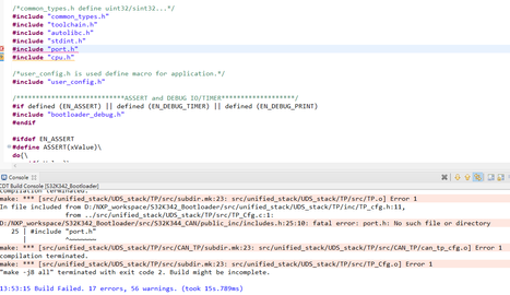

HarrySu
I think the problem may be that I didn't include cpu.h and port.h in the includes.h previously,
but now that I have added them, it says that cpu.h and port.h cannot be found. How can I resolve this issue? Thanks!
Harry
22,036 Views
nxf10035
Hi, @HarrySu
      The CPU.h and port.h is used other platform. For S32K342, you should follow S32K3x2 bootloader configuration and linkfile. S32K3x4 and S32K3x2 have some different.
