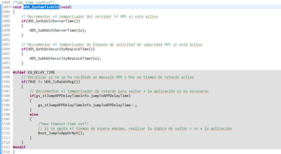

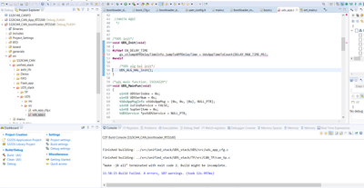

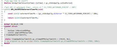

I am using the project "S32K344_Can_bootloader_RTD200" in the microprocessor S32K344. I want to download an application with the program of bootloader. I have achieved the jump from program to application but I have different questions.
1. I want to use #define EN_DELAY_TIME but when I uncomment the command in the folder "public_inc", the program has different errors. My target to use "Backdoor", that is to say, I want to check if the program has to enter to bootloader or not. I don´t know the process and the different functions that I have to use to achieve the target. I want to use the function "Boot_CheckReqBootloaderMode(void)" but when I debug the program, it never enters to the "if". Could you explain me the process and the steps to achieve the target. I add different functions that I think are important.
2. I don´t know if I have to modificate the parameters of "static tJumpAppDelayTimeInfo gs_stJumpAPPDelayTimeInfo = {FALSE, 0u};". I have to change this structure ? You can see all structure in one of the next pictures.

nxf10035
Hi, @JonAnder_Amante
   The DELAY_MAX_TIME_MS is used to, enter bootloader mode and have not received any UDS commands, if waiting DELAY_MAX_TIME_MS timeout, then jump to APP if APP is valid. You un-need to modify the global variable or content.

nxf10035
    I checked the code. The error maybe we have not used feature in new bootloader version. So, always disable the macro. If you want to enable the feature, suggestion:
1. Create a new function in uds_app_cfg.c
 void  UDS_Cfg_Init(void)
#ifdef EN_DELAY_TIME
gs_stJumpAPPDelayTimeInfo.jumpToAPPDelayTime = UdsAppTimeToCount(DELAY_MAX_TIME_MS);
#endif
2.  UDS_Init
   -Remove the code
     #endif
 - Call UDS_Cfg_Init(); in UDS_Init
Hope this can help you!

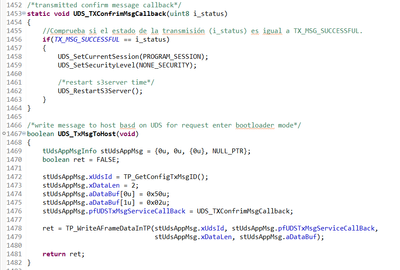

JonAnder_Amante
At now I dont´t receive the error of implementation but I have different questions about this. I don´t know how I can send the request to enter to bootloader. I have looked and I have seen that in my program the function "if(gs_stBootInfo.requestEnterBootloader == *((uint8*)gs_stBootInfo.requestEnterBootloaderAddr))" never is True so I think that I have a problem in this function. I also send you the value of these parameters. Maybe the configuration is done from "ECUBUS" application but I don´t know how send the request of bootloader (I have also sent you the picture of the ECUBUS because perhaps I have to do some configuration in ECUBUS).

nxf10035
    ECU-BUS send the UDS command (0x10 0x02) will trigger the APP reset and enter bootloader. If only have bootloader in MCU, then the bootloader will not reset.

JonAnder_Amante
1. I don´t understand what you have explained me so could you tell me the steps to achieve that this function to be True "if(gs_stBootInfo.requestEnterBootloader == *((uint8*)gs_stBootInfo.requestEnterBootloaderAddr))".
2. Moreover, coould you tell me how I can send the request of bootloader because I don´t know how to do it.
3. Finally, could you tell me the purpose to send the service "WriteDataByIdentifer". I send you different pictures again.
