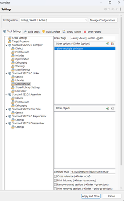

I am currently applying the lwIP TCP/IP stack to the S32K314 product and encountered a "multiple definition" error, so I am leaving a question.
When I add the TCP/IP stack to the peripherals and build, the following error occurs:
However, when I remove the multiple definition issue using linker options, the build succeeds as follows:
Using linker options to bypass the multiple definition issue does not seem like a proper solution, so I want to address the root cause of the problem.
Thank you.

Hi @malove
In the actual example, fsdata.c is not included for the compilation. only fs.c included.
You can exclude the fsdata.c from build to avoid fsdata.o generation. which will help you to solve the problem without modifying the linker options.
Sathish.

malove
Thank you!

Hello @PavelL
What I want to clarify is that I am not trying to have two static IP addresses.
Instead, I am trying to resolve the issue where certain elements in the fsdata.c source file are being defined multiple times.
However, this file is not something I wrote myself; it is part of the TCP/IP stack that I am using as is. I am not sure how to modify or resolve this issue.
