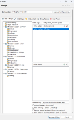

I am currently applying the lwIP TCP/IP stack to the S32K314 product and encountered a "multiple definition" error, so I am leaving a question.
When I add the TCP/IP stack to the peripherals and build, the following error occurs:
However, when I remove the multiple definition issue using linker options, the build succeeds as follows:
Using linker options to bypass the multiple definition issue does not seem like a proper solution, so I want to address the root cause of the problem.
Thank you.

Hi @malove
In the actual example, fsdata.c is not included for the compilation. only fs.c included.
You can exclude the fsdata.c from build to avoid fsdata.o generation. which will help you to solve the problem without modifying the linker options.
Sathish.
