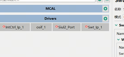

Hello
Is there any sample program for watchdog and detailed instructions?
BestRegards,

Senlent
Hi@Simon-Liu
This may be a problem with the IDE, you can try the following methods, maybe this problem will disappear
try to remove the “compatibility.xml” located at “C:\NXP\S32DS.3.4\eclipse\mcu_data\configuration”

Senlent
Hi@Simon-Liu
you can find reference demo code in S32 DS like picture below.
for more detail, you need to read datasheet.

Simon-Liu
Contributor V
Hello @Senlent
Thank you for your reply.
I have used S32DS to generate samples before, but some errors were reported so the code cannot be generated (the tool did not report errors when I generated other samples before). Can you give me your project for reference?

Senlent
Hi@Simon_Liu
please tell me the RTD version you're using and you can try to click Update Code button, this issue maybe will disappear

Simon-Liu
Contributor V
Hi @Senlent
The RTD version I use is as shown below.

Senlent
Hi@Simon-Liu

Simon-Liu
Contributor V
Hello @Senlent
Thank you for the attachment you provided.
I deleted the file "compatibility.xml" but the problem still exists.
