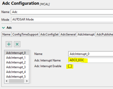

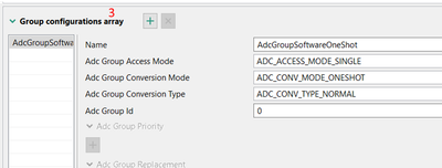

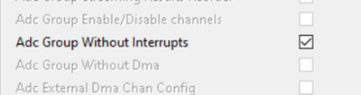

To use Adc read without interrupt, you need to enable this feature in Group configurations array container
Then disable Interrupt EOC in AdcInterrupt container:
When using this feature, you don't need to config interrupt after conversions, instead, only Adc_ReadGroup() can be used to get conversion results.
So the sequence in implementation should be:

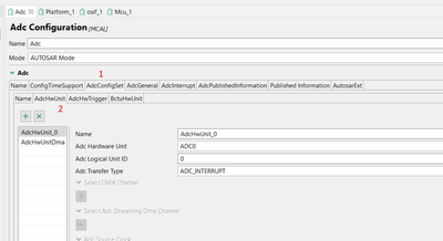

vasanth-sr
I m using S32design studio 3.5.
I don't have this enable option.
I attached the screen short , please find the attachment.
vasanth

cuongnguyenphu
Let's follow this to enable Adc without interrupt:
cuongnguyenphu_0-1673408057843.pngcuongnguyenphu_1-1673408076919.pngcuongnguyenphu_2-1673408086674.png
Because we cannot check Interrupt notification to notify the conversion finished, then we need to use timer and polling function ReadGroup() to get Adc results
