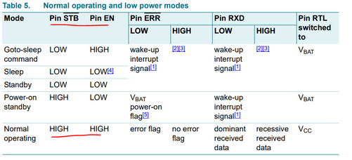

Hello, I'm using the tja1055 as a transceiver. I'm facilitating two-way communication (meaning there's a receiver and a transmitter). I'm using the s32k312 as the processor. As a trial, I have a test code for receiving and transmitting in loopback mode. When I test this code, it works seamlessly. However, in normal mode, I'm not receiving the 'Receive callback.' I can see the signal of the message I send on the RX pin of the receiver transceiver. My message-sending code is a modified version of my loopback code, and my receiver code is the same code with the sending part turned off

1.please double check wether TJA1055 is right configured before use.

Hello, I'm seeing VCC voltage when the line is idle (no messages are being sent). Doesn't this indicate that two transceivers are active and in normal mode? Also, I'm applying 1-1 values to the STB and EN pins. I'm seeing 12V on the INH pins of both transceivers (12 volts being my BAT voltage).

1. Have you configured and initialized the pins correctly?
2. If everything is configured correctly, then you can use tools such as an oscilloscope or logic analyzer to test whether the TX output on the MCU side has the correct output.
3. If the TX on the MCU side is normal, then solve the problem of TJA1055. Usually the STB and EN pins should be controlled by the MCU side.
Input requirements for STB and EN pins

Im usign PTA6
