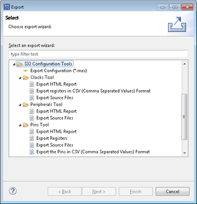

I'd like to know if there is a possiblity in S32 Design Studio v3.5 to export the Pin configuration and Clock diagram reported on mex file in CSV or in XLSX format?
In the Export dialog box, double-click S32 Configuration Tools. Click to export the MEX file, or expand the tool folder and click to export the pins and clocks configurations to the CVS file.
Click Next.
Select the folder and specify the filename you want to export.
The exported files contain the content of the Pins or Clocks view and list the functions and the selected routed pins.
