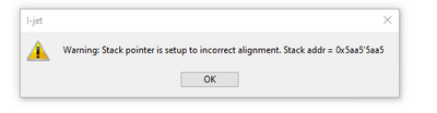

I tried to export my S32DS project to IAR EWARM by referring to the link below.
HOWTO: Export S32DS Project to IAR EW (S32K14x/S32K11x)

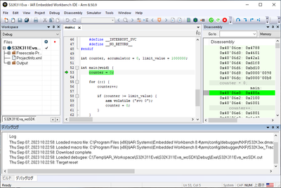

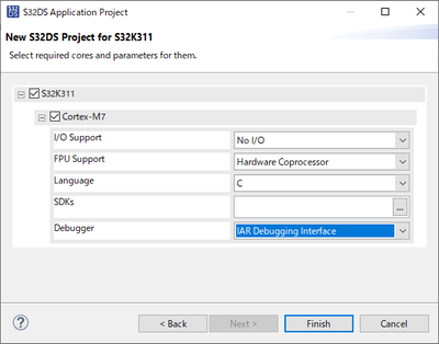

If I did not select SDKs, I was able to debug successfully.

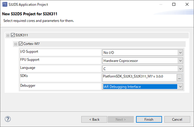

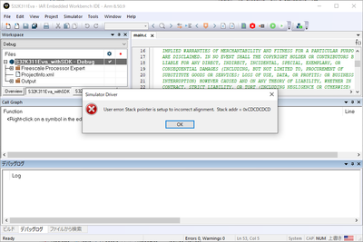

However, if I select a SDK, a stack pointer alignment error occurs when debugging starts.
I set "alignment = 8" in the icf file but no improvement.
The project is not modified from the one generated by S32DS, do I need to make any changes?

 This is error message seen.
I have attached my .map and linker here in case its needed.
