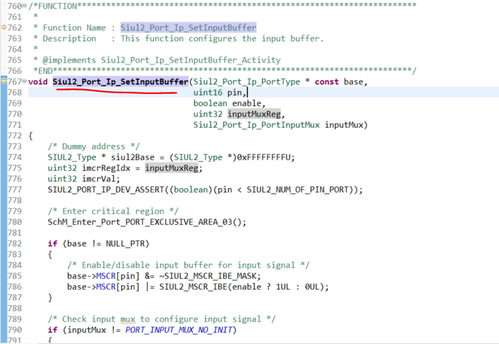

Hello S32K3 Team,
I would like to switch SIUL2 Port configurations during run-time without the Deinit<->Init process. It would be great if we could switch between lpuart-tx and gpio-output. I look forward to your valuable suggestions.

Hi@NewbieNerd
please take a look this function:
