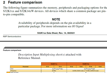

I now need to port the S32K148 based project to the S32K144 development build. What should I do.
1,111 Views
Senlent
Hi@KYT
1.First of all, you need to have a good understanding of the differences between the two chips and make modifications based on the differences.
you can find the below image in S32K-DS
2.In terms of software, it is not possible to convert the S32K148 project to S32K144 directly through the IDE, so you need to create a new S32K144 project and modify the project by comparing the differences in peripherals, ports and memory modules etc...
