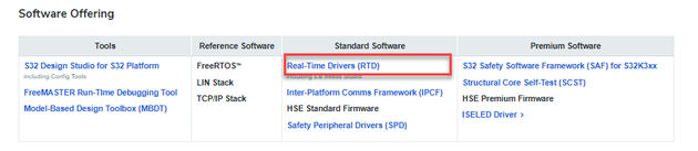

Is there S32K3xx SDK available like S32K1xx (S32SDK_S32K1XX_RTM_4.0.2)?
1 解答
5,348 次查看
Senlent
Hi@Darshna
S32K3 only has RTD, there is no RTM version similar to S32K1

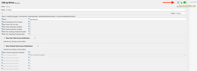

I am looking for the user manual of the SDK for S32K3XX, a PDF document detailing all the functions that make up the SDK and, if possible, examples of their use. Does such a document exist?
4,493 次查看
not_a_duck
I personally haven't found such a document, but the best thing i can suggest is looking at the UM (user manual) and IM (interface manual) that are included with each of the modules.
Screenshot 2024-05-28 at 8.35.58 AM.pngScreenshot 2024-05-28 at 8.35.58 AM.png
Screenshot 2024-05-28 at 8.32.26 AM.pngScreenshot 2024-05-28 at 8.32.26 AM.png

@Senlent  When will the RTM become available for the S32K3 series?
5,349 次查看
Senlent
Hi@Darshna
