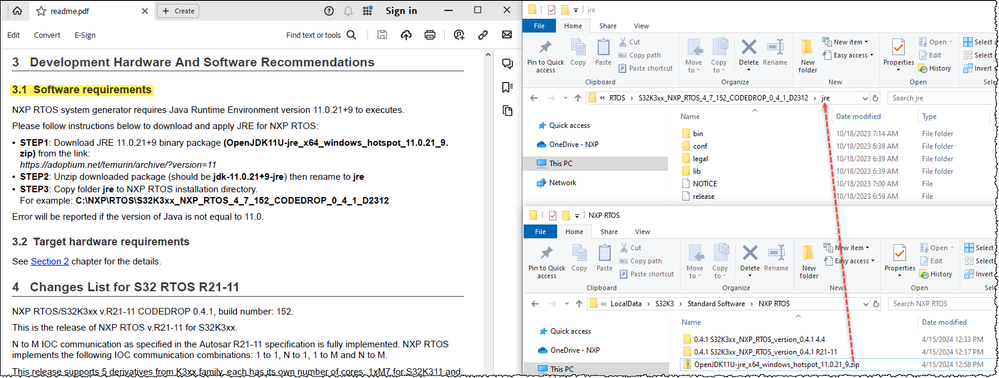

    I use the EB tresos to generate the RTOS version 0.4.1, even with the sample project, there are two error messages (By the way, I can generate with the IDE version, not the EB tresos version.)
    How to solve this?

Please read the chapter 3.1 Software requirements of readme.pdf (C:\NXP\RTOS\S32K3xx_NXP_RTOS_4_7_152_CODEDROP_0_4_1_D2312)
NXP RTOS system generator requires Java Runtime Environment version 11.0.21+9 to executes.
Please follow instructions below to download and apply JRE for NXP RTOS:
• STEP1: Download JRE 11.0.21+9 binary package (OpenJDK11U-jre_x64_windows_hotspot_11.0.21_9.
zip) from the link:
https://adoptium.net/temurin/archive/?version=11
• STEP2: Unzip downloaded package (should be jdk-11.0.21+9-jre) then rename to jre
• STEP3: Copy folder jre to NXP RTOS installation directory.
For example: C:\NXP\RTOS\S32K3xx_NXP_RTOS_4_7_152_CODEDROP_0_4_1_D2312
Error will be reported if the version of Java is not equal to 11.0.
