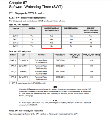

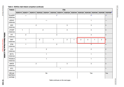

Why is it found in Section 67 that S32K328, 338, 348, 358 support 3 SWT instances? We do see in section 2.5 that 2, 3, 1, and 2 SWT instances are supported respectively.
Li 3.
1,857 Views
petervlna
SWT chapeter description does not look correct to me.
You have one SWT for one active core (not for lockstepped), so you can refer to this simple rule.
Table 5. is correct.
Peter

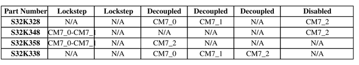

Is CM7_0-CM7_1 a kernel? Does Disable mean an unwanted kernel?
Li 3.
1,851 Views
petervlna
Disabled in this case means N/A. There is no point to have that column in the manual as those cores are not available.
What is Lockstep and Decoupled?
Li 3.
1,778 Views
petervlna
From general uC theory:
Dual-redundant core (lock-step) CPU functionality
One of the most common techniques for implementing replication in automotive MCUs is called 'lockstep'. Lockstep means that two processors are running the same set of operations in parallel. The two sets of results are compared by a checker unit or comparator to look for single point faults.
Decoupled
Independent operation on each core.
