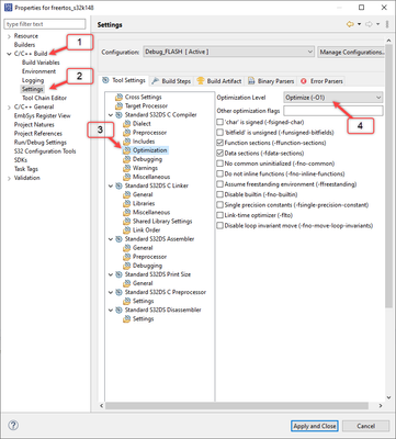

Chandra13
Hello @VaneB ,
Thank you for the feedback.
Even with your suggestion, the program still didn't respond after one execution. But after I removed the "printf" statements, the program is working fine.
Do you know why the printf statement is stalling the program?
Also, is there any option in the Design Studio to turn off the compiler optimizations?
2,766 Views
VaneB
Hi @Chandra13
You can change the optimization level in the project's properties. Please refer to the attached image.
Regarding the printf issue take a look this post: Function printf in S32 Design Studio
