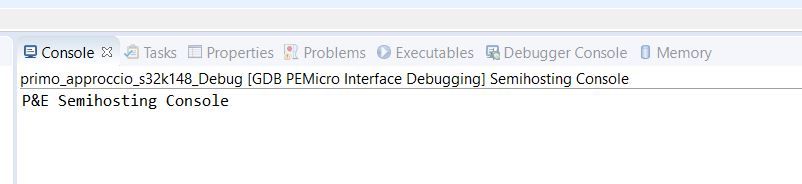

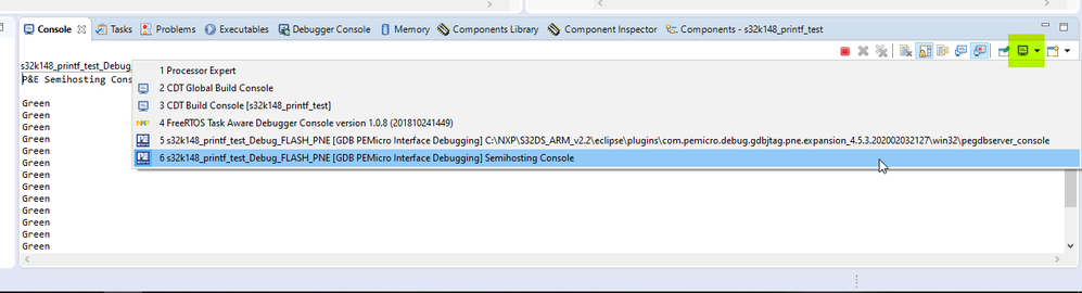

jiri_kral
the printf output is shown in semihosting console:
If console is not visible for some reason - you can open it in console menu:
Hope it helps.

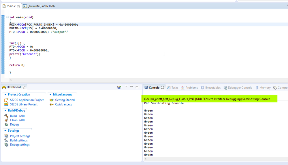

peter_thompson
Odd. I just created new example, set the library to ewl_c debugger, added include <stdio.h> and the printf worked.
So, I think I’m good for now. Thanks for your help.

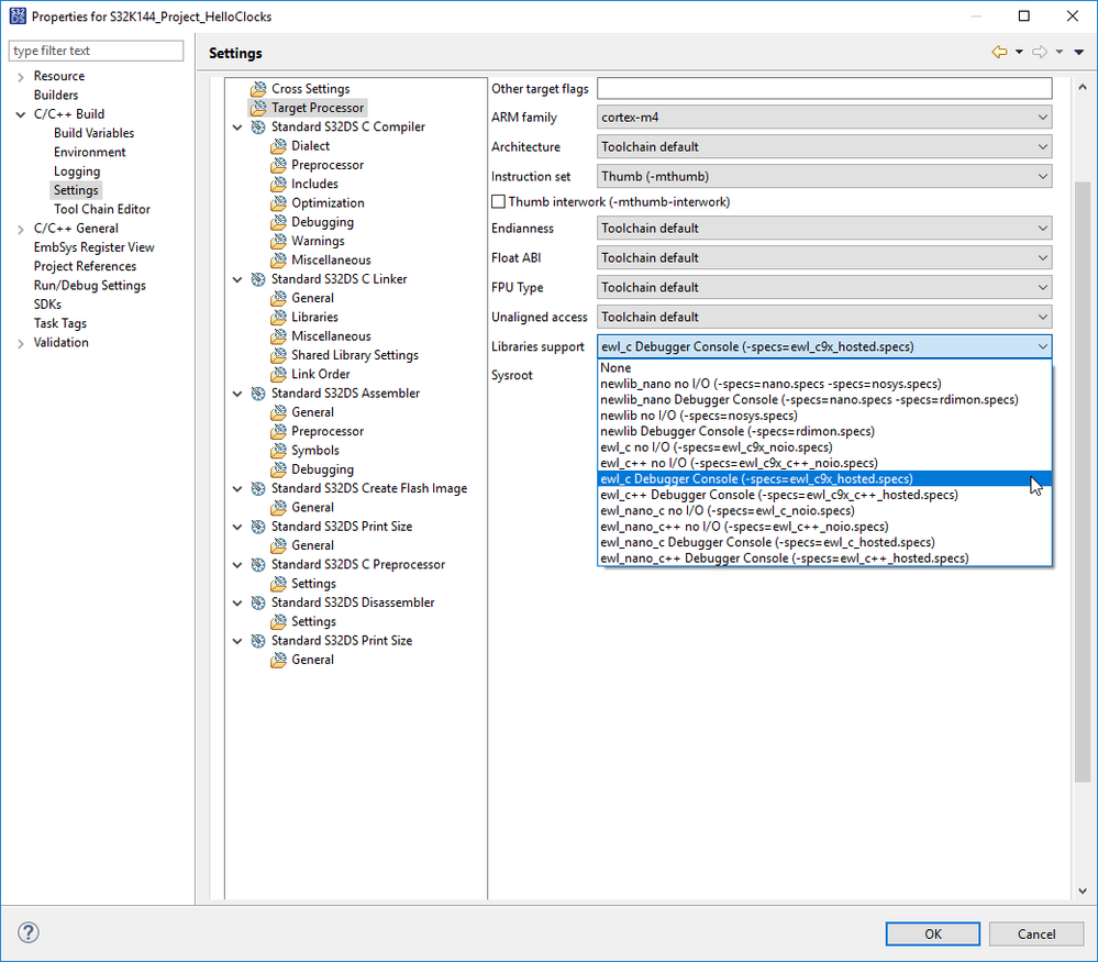

jiri_kral
you need to use lib C with Debugger console:
printf output is shown in Semihosting console.
Hope it helps.

tzeng015
ewl_C Debugger Console ??
I can’t see it .

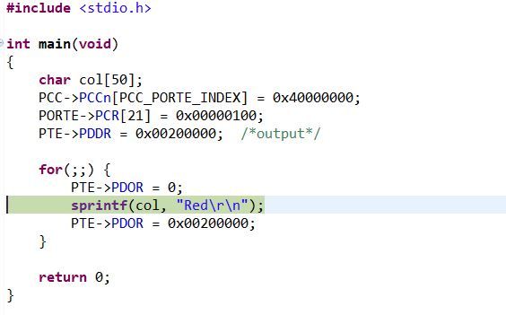

p_decesare
Hi Jiri Kral
thank you for your answer. I don't resolve the problem.
Here two figures.
I follow your advice, in fact I set the option of Libraries Support. But at the Console I don't see the word Red.
Can help me?

jiri_kral
sprintf is for printing into string (memory). Try to use printf instead.
Jiri
