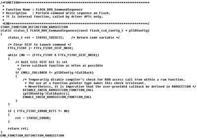

lukaszadrapa
There's simple rule - whatever the situation is, you can't access a flash block which is being erased or programmed. As you can see in the source files, FLASH_DRV_CommandSequence is executed in RAM:
Not sure what kind of differences you did, so please check if the function is really executed from RAM.
And try to disable interrupt when programming the flash. This is the most common issue.
Lukas

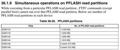

lukaszadrapa
Hi @chilambarasanm
this is caused by Read While Write (RWW) error.
RWW is supported only between partitions/blocks. S32K146 has two 512KB blocks of program flash memory. When a block is being programmed or erased, the code must run from different block or from data flash or from RAM. If there are interrupts which could access the block, it's necessary to either disable all interrupts or put all the interrupt resources (vector table, ISR handlers...) to different block or to RAM.
Some screenshots from the reference manual:
Lukas
