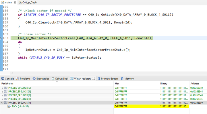

The C40 Driver faults on Dflash when trying to unlock sector 11 in Dflash on the S32K344 T Box. When using a gdb debugger, I try to manually unlock the SPELOCK on the 11th bit and it fails. I've tried disabling the DMEEE in the PFLASH_PFCR4. The first 0-10 sectors successfully unlock and can be programmed and erased. I suspect a CRC error because of a prior faulty C40 erase/program or it being reset early.
Is there a way to do a full erase (similar to the Kinetis board mass erase option in S32DS) to reset the dflash of the board?

Trying to unlock address 0x10016000 to erase sector 11. It hardfaults when attempting to clearlock (C40_Ip_ClearLock). This is for the RTD AUTOSAR 4.7

An additional note: in our tests, we have tried to unlock sectors 0-16 in a for loop and it hard faults on 11. We have also tried to unlock only sector 11 in isolation and that also induces a hardfult.

For faulting syndromes, we checked the FCCU and ERM registers as well and this is what we found:
- NCFS2 and NCFS0 of the FCCU set immediately on boot, yet this was also the case for a working board.
- Channel 11 (Cortex-M7_0 D0TCM) and 12 (Cortex-M7_0 D1TCM) of the ERM was reporting a non-correctable ECC error event at the time of the hardfault
- all SETSLOCK registers were zero on boot and at time of hard fault
- we were able to eliminate the ERM errors by setting the PFLASH_PFCR4_DMEEE_MASK in the config register
- we were are able to clear the super sector locks, but this did not have an effect
This ECC error lead us to believe that there was a corrupted flash program, but we also confirmed that the fault occurs on the unlock_sector call which is separate which is strange. Are there any other relevant fault registers we should check?

The RTD version is: S32K3_RTD_3_0_0_D2303_ASR_REL_4_7_REV_0000_20230331.
To add some context, we have several boards that are running the same binaries without losing control to specific sectors in flash and 2 other boards that have run the same binary and hardfault because it can't unlock certain sectors (in our case sector 11). On those hard faulting boards, we can unlock sector 1-10 fine.
