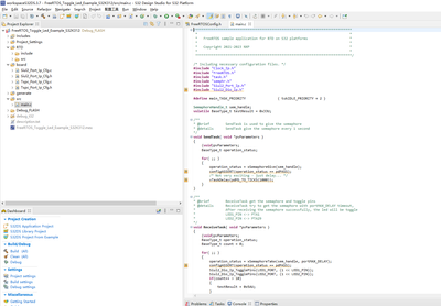

Hello NXP colleagues,
There are showing so many faults for syntax.
console showing:

Hi @Hanoch
Which version of RTD and FreeRTOS are you using? I assume you are using the sample codes provided with the FreeRTOS packages. If so, did you make any changes to the code? If so, could you share your project?

OK, porject imag:

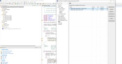

SDKs:
RTD and example version:

Hi @Hanoch
I have installed the FreeRTOS package and used the same example project you are using and my S32DS does not show any inclusion issues or syntax errors.
However, looking at the RTDs you have installed, I see that in addition to the RTDs 3.0.0, you have the version 2.0.2. With S32DS 3.5 we have had several problems when installing more than one RTD version of the same family (in this case S32K3), therefore, I would recommend uninstalling both versions of RTD and reinstalling only version 3.0.0 and the FreeRTOS package. This also involves deleting the example from your workspace and recreating it once you finish reinstalling the packages.
